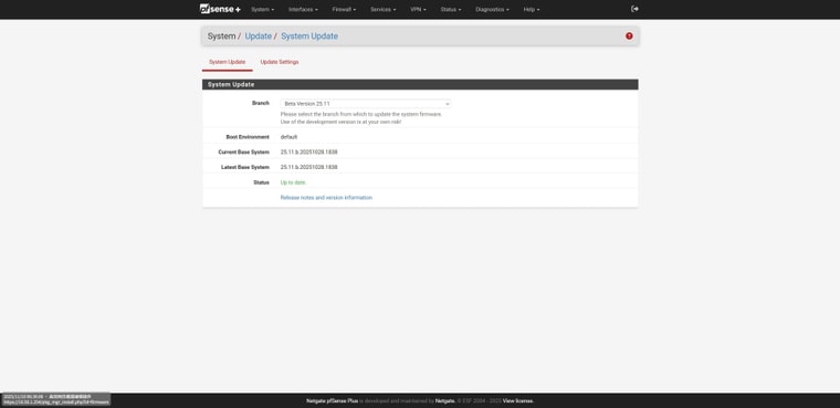

                I can't see other version settings right now, only the 25.11 category version.

                  @yon-0 25.11.b.20251028.1838 is also the latest version I got.
                    marcosm Netgate
                    The current pkg version for 25.11 is 2.3.1. Perhaps something happened during a previous upgrade? I think 1.3.14 is from before the FreeBSD 16 update. You might need to reinstall packages or roll back to a previous BE and try the upgrade again.
