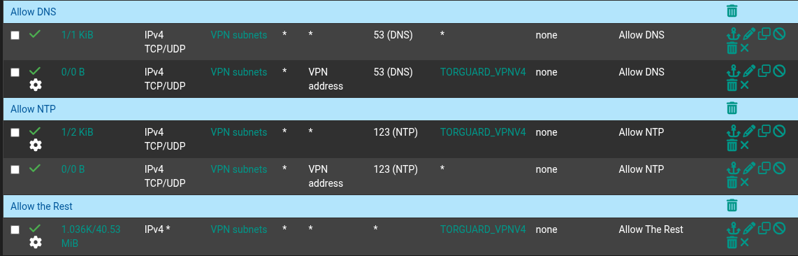

      I have a PFsense+ - running a VPN klient, where I route a subnet through.
      This has been working fine, but for some reason my 2 Shields are not showing no NTP or DNS in that subnet, making them not run as optimal as it used to a couple of days ago. I can't remember or see anything changes that could carse this in the PFsense history.
      I've just testet creating a new VM in that subnet - having no issues with neither DNS or NTP
      Its just my 2 Shields in that range( provided by a static lease by DHCP) they say they are missing time etc.
      The Shields contains a Kodi App for my movies - Which can not scan for new movies - carse the NTP - but the Shields provide an information that there's not network - allthough the devices have IP.
      What can carse that suddenly my 2 shields looses this option for ntp ? Since my VM-test have no issue with ntp or DNS, as other existing machines not having these issues. My Rules have been looking like this since May:

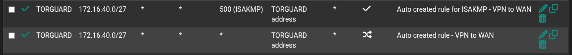

      For Outbound routing - it'll look like this for the subnet
      In short this means my time on my shields are not correct , all EPG etc does not match my locales and years

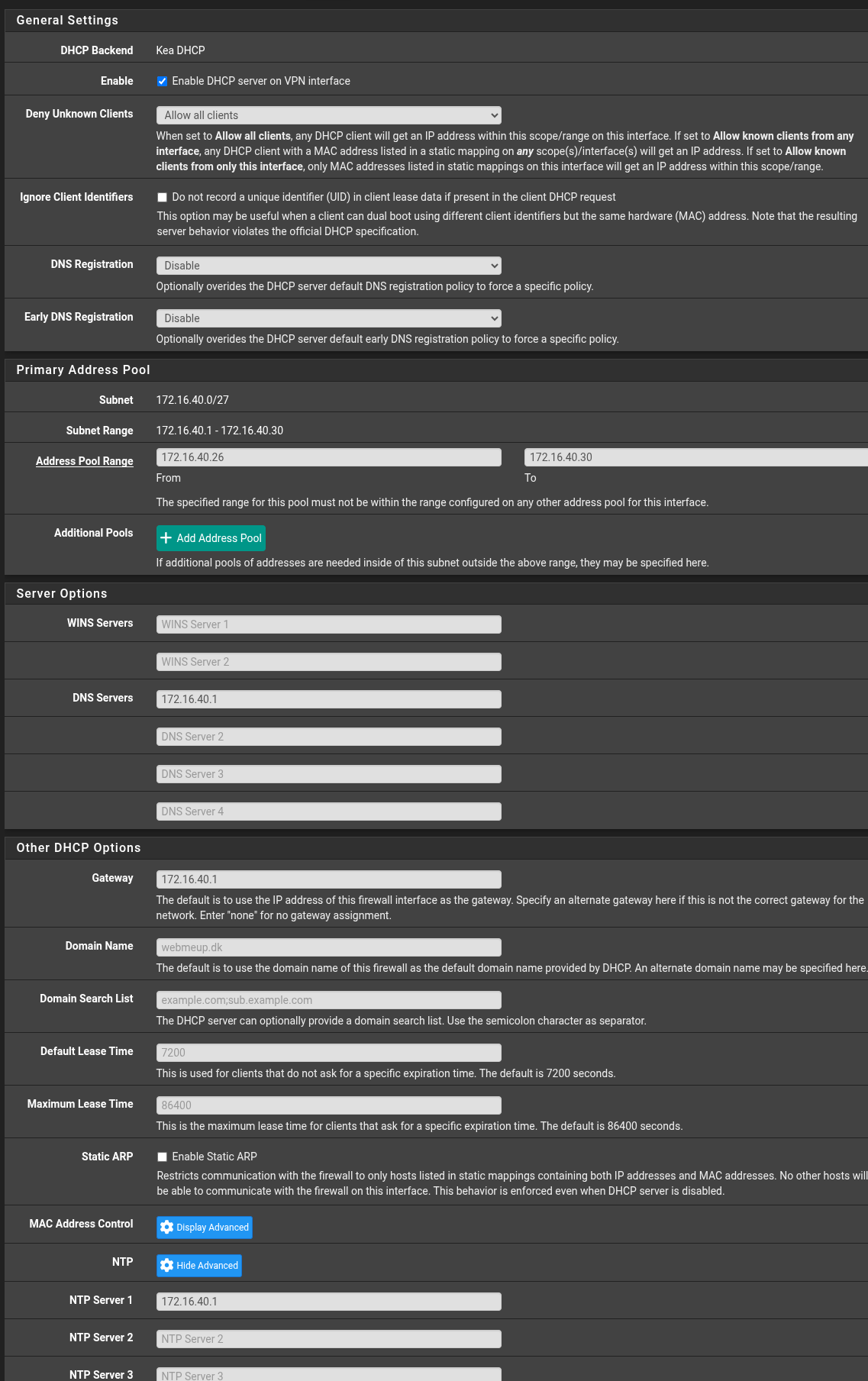

      When I'm creating the DHCP-server - It'll have the rules as look here:
      But I can not figure out why only my 2 shields are stock Not getting a NTP or DHCP server (Eventhough when I start the programs up - mostly are working but absolut not all - that are time dependent such as The weather and EPG setup)
      Can anyone see any mistakes that Im missing here - since I'm missing those 2 critical services
      TIA

        DHCP is special.
        When you create an interface, you have to set up a pfSense DHCP for that interface. Assign it a pool, and this pool must be part of that interface's subnet.
        No need to create firewall rules for DHCP, pfSense did that for you "behind your back", not showing them in the GUI.

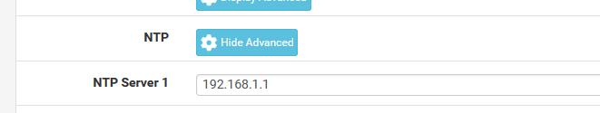

        Yeah, the DHCP server will announce a NTP IP (not a host name !!) if - and only if - the DHCP client asked for one.
        Don't presume her : again, look for yourself : packet capture the DHCP traffic, and you can see the DHCP Lease request. Look carefully : did it ask for a NTP IP ?
        If not, the server won't send it neither.
        And guess what: most devices these days don't ask for NTP IP during their DHCP lease request.
        Don't ask me why ^^
        And on one side, all devices use TLS these days, so the current time/date is very important.
        Still, you have to set a manual or static NTP IP address somewhere on that device to make that happen. Or it could be done over DHCP ....

              Yes - my DHCP announces my NTP and DNS - which is also is listening on the interface on my VLAN40 - 172.16.40.0/27 which is the subnet created on my PFsense
