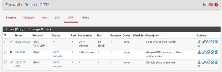

      Hello everyone!
      Despite the firewall rule in OPT1, the two networks can communicate with each other.
      Source: OPT1 net
      Destination: LAN net
      Action: block
      Either I missed something or more rules are needed.
      It is quite important because in the short term there are other network segments that are not allowed to "talk" to each other.
      cheers

        @jogovogo Did you clear existing states before you tested?
        https://docs.netgate.com/pfsense/en/latest/monitoring/status/firewall-states-reset.html
        BTW, those last 2 rules will never hit since they're after the Allow Any rule.
        J 2 Replies Last reply Reply Quote 0

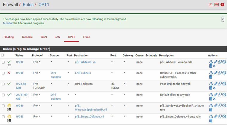

              patient0 @jogovogo
              @jogovogo the block rule with source OPT1 subnet to LAN subnets does not have any hits, it's 0/0 B. Have you applied the rule after having created it?
              Are LAN and OPT1 on different ports or VLANs? And the rules we see are on the OPT1 tab?
              Btw: your rule will (should) prevent access from OPT1 to LAN. You'll need a similar rule on LAN if you want to prevent LAN to access OPT1.

                OPT1 is vlan 22 and yes the rule is on the OPT1 interface.
                But what I noticed now is that the rule somehow slips down by itself...

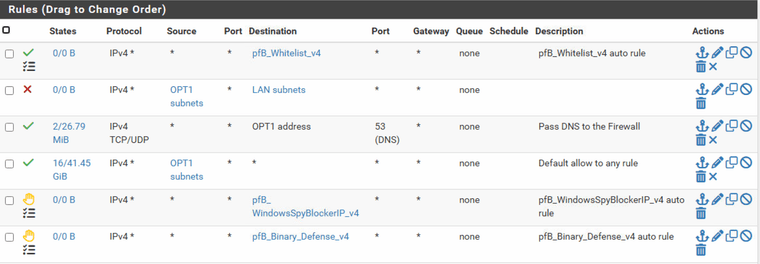

                  patient0 @jogovogo
                  @jogovogo said in Traffic between OPT1 net and other networks e.g. LAN net:
                  Ah, that would explain it. The rules are first-match so that rule won't run because the third rule matches first.
                  Moving it above the "OPT1 subnets * *" will make work.
                    jogovogo @patient0
                    @patient0
                    That's how it's meant, but it just slides down by itself...

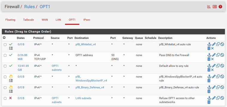

                      tinfoilmatt @jogovogo
                      You need to read and understand the setting at: Firewall / pfBlockerNG / IP / 'IP Interface/Rules Configuration' / Firewall 'Auto' Rule Order.

                        • tinfoilmattT Offline
                          @jogovogo The setting affects the ordering of all rules in the ruleset.
                                  @jogovogo From what you've shared, it appears the default ordering format (i.e., "| pfB_Pass/Match/Block/Reject | All other rules | (Default format)") works perfectly for you—as long as you keep the "Refuse OPT1 access to other subnetworks." deny rule above the "Default allow to any rule" pass rule of course...
                                  And unless you expect any non-"OPT1 subnets" DNS traffic to arrive on OPT1, the "Pass DNS to the Firewall" pass rule is unnecessary.
                                  EDIT: The "Pass DNS to the Firewall" pass rule may be necessary if the "OPT1 address" IP is contained within the "LAN subnets" alias. (And in such as a case, it would need to remain above the "Refuse OPT1 access to other subnetworks." deny rule.)
                                  SECOND EDIT: I maintain that unless you expect any non-"OPT1 subnets" DNS traffic to arrive on OPT1, the "Pass DNS to the Firewall" pass rule is unnecessary.
