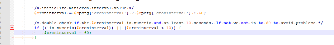

            Suggestion :
            /etc/inc/captiveportal.inc :
            You see the variable "$croninterval" , It doesn't even exist in the pfSense config file.
            It isn't surfaced in the GUI neither ...
            What happens if you decide that pruning happens every ... 300 seconds instead of 60 seconds ?
            Have a look at what captiveportal_prune_old() does.
