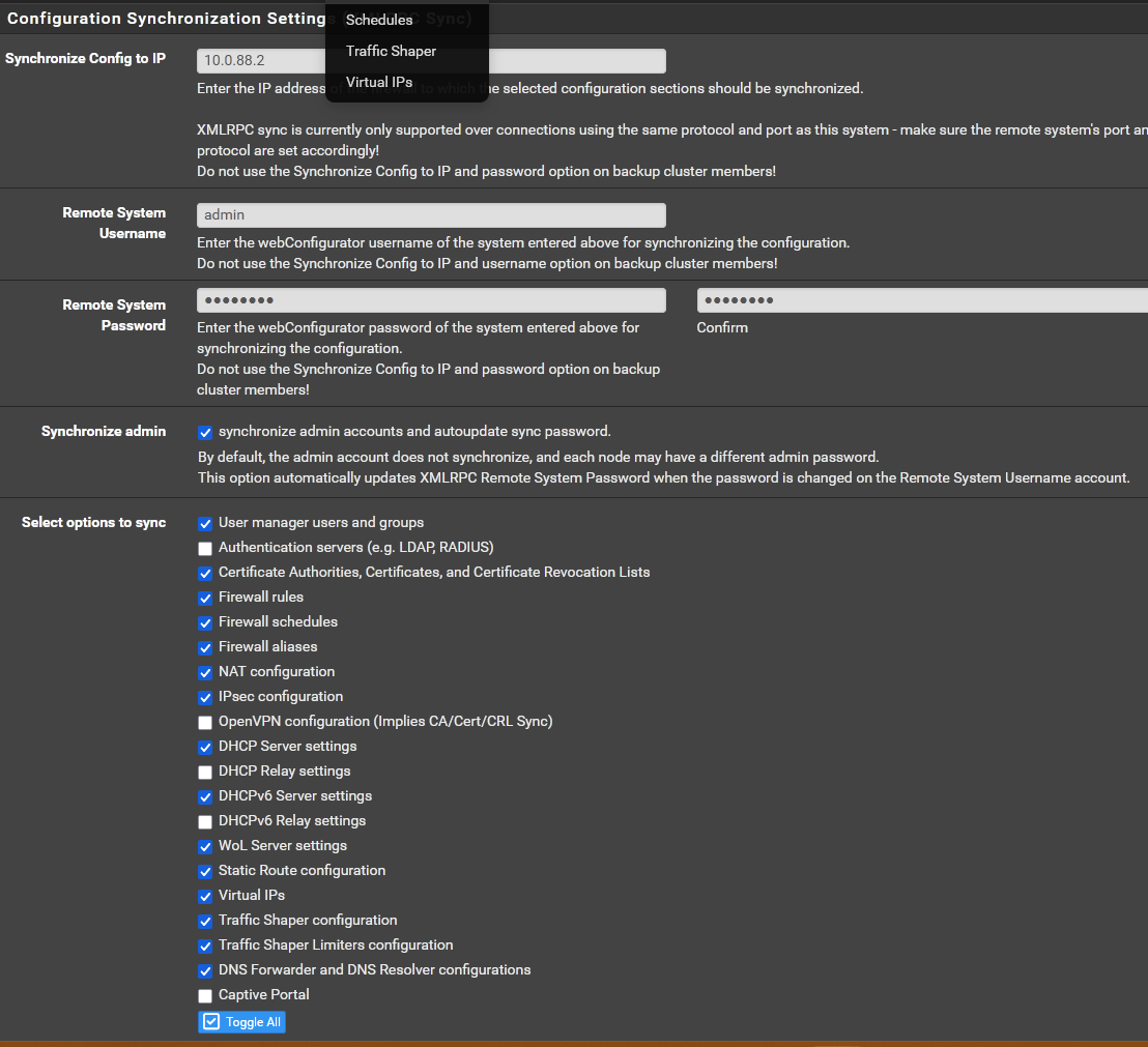

By the way, here are my sync settings:

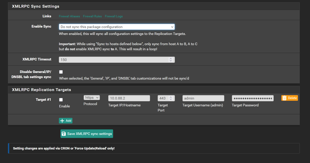

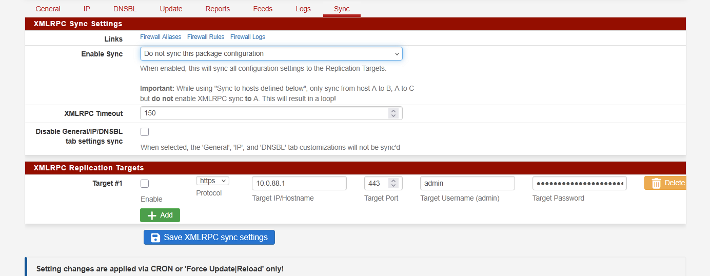

And on the backup everything is unchecked.
