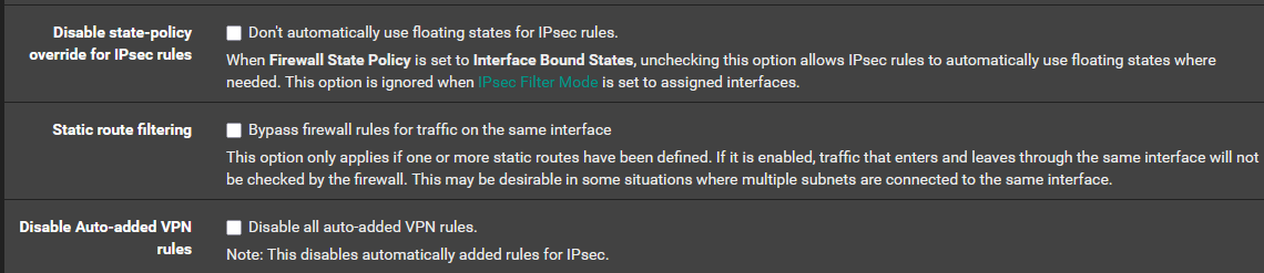

                SteveITS Galactic Empire @mrsunfire
                @mrsunfire In System > Advanced > Firewall is "Disable Auto-added VPN rules" checked or unchecked?
                Upvote 👍 helpful posts!
                  mrsunfire @SteveITS
                  @SteveITS Everything is unchecked. But I don't see any added rules for IPsec at all.
