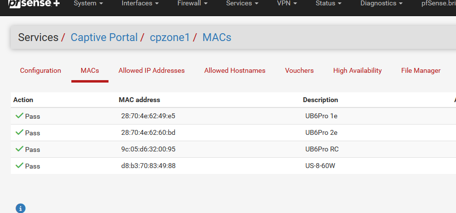

        For every MAC you add here :
        there will be no login page, these devices are granted right away.
        And yes, you have to copy them over.

          @Gertjan Thank you, yes, I have copied the ~900 static ARPs from DHCP to capive with a little bit of vim macros, copy/paste, import/export wich is fine for now.
          While doing it, I've understood the best way to do it.
          First of all, I have to disable static arp, as if it is active, the "dynamic" hosts will not be able to communicate with the firewall. Now, the static entries in DHCP are only used to assign static IPs. Checking the access is exclusively done by the captive portal.
          I have to set up an IP range that is dynamic and one that is static, and do not overlap.
          In order to allow some host to bypass the portal, I have to insert their MAC adress in the portal section, they may be static or not, it does not matter.
          In practice we may actually just use the portal-bypass part, as for 95% of our static hosts, it is not the static part that is important, but the non-interactive connection. The hosts that need to be static could even be configured static by hand outside of the dhcp range.
