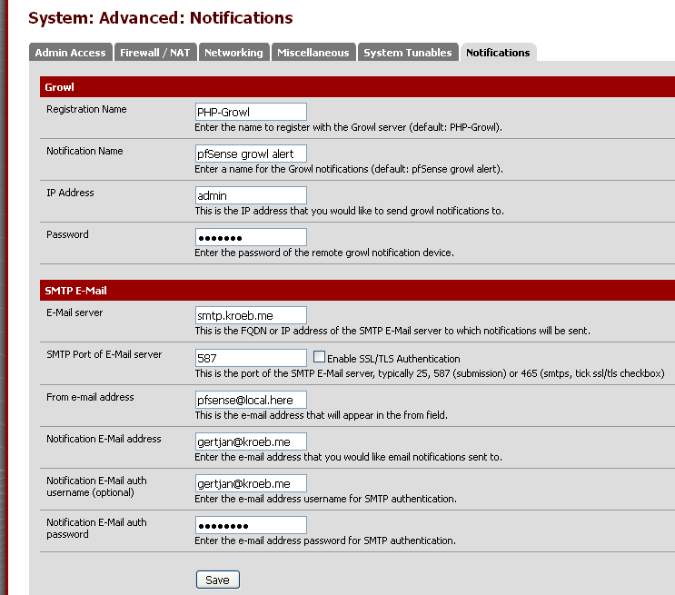

                    Gertjan
                    The mail message I was talking about above, was send with this setup:
                    This means that authentication by submission - sending mail on port 587 - with user name and password, is fully supported by pfSense.
                    The only limit is you and your PHP form  ;)
                    Btw: for all the mail possibilities, look in
                    /etc/inc/notices.inc  (take a look at lines 286 -> 332)
                    /etc/inc/smtp.inc
                    /etc/inc/sasl.inc
                    and more, if needed.
