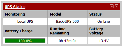

    Attempting to write NUT UPS Status widget for Dashboard
    7 Posts 3 Posters 6.8k Views
    • T Offline
      tweek
      I'm trying to write a Dashboard widget for the NUT package.  I've got it to display the data I want but the data is static and won't update the changing data using that AJAX magic.  Most of the data I want to see update (Status, Battery Charge, Runtime Remaining, Battery Voltage) is getting pulled using a popen call and parsed into an array from which I grab the individual data items.  Can I get these data items within the widget to refresh automatically?
      If someone is interested in helping me out I can post the code, most of which is just lightly modified code from the NUT package's status_nut.php file.

                  I received an email from user "LostInIgnorance" asking me to post the code I have.  I am posting the version I wrote before attempting to add the automatic AJAX widget refresh code.  It is as follows:

                  $nocsrf = true;
                  require_once("guiconfig.inc");
                  require_once("pfsense-utils.inc");
                  require_once("functions.inc");
                  $nut_config = $config['installedpackages']['nut']['config'][0];
                  /* functions */
                  function secs2hms($secs) {
                  	if ($secs<0) return false;
                  	$m = (int)($secs / 60); $s = $secs % 60;
                  	$h = (int)($m / 60); $m = $m % 60;
                  	return array($h, "h ", $m, "m ", $s, "s ");
                  function tblrowbar ($value, $symbol, $red, $yellow, $green) {
                  	if(!$value) return;
                  	$value = sprintf("%.1f", $value);
                  	$red = explode('-', $red);
                  	$yellow = explode('-', $yellow);
                  	$green = explode('-', $green);
                  	sort($red);
                  	sort($yellow);
                  	sort($green);
                  	if($value >= $red[0] && $value <= ($red[0]+9)) {
                  		$color = 'black';
                  		$bgcolor = 'red';
                  	if($value >= ($red[0]+10) && $value <= $red[1]) {
                  		$color = 'white';
                  		$bgcolor = 'red';
                  	if($value >= $yellow[0] && $value <= $yellow[1]) {
                  		$color = 'black';
                  		$bgcolor = 'yellow';
                  	if($value >= $green[0] && $value <= ($green[0]+9)) {
                  		$color = 'black';
                  		$bgcolor = 'green';
                  	if($value >= ($green[0]+10) && $value <= $green[1]) {
                  		$color = 'white';
                  		$bgcolor = 'green';
                  	print(<< <eod<br>{$value}{$symbol}
                  EOD
                  	."\n");
                  | Monitoring | Model | Status |
                  	$running = ((int)exec('pgrep upsmon | wc -l') > 0) ? true : false;
                  	if($nut_config['monitor'] == 'local') {
                  		echo "Local UPS";
                  		$cmd = "upsc {$nut_config['name']}@localhost";
                  	} elseif($nut_config['monitor'] == 'remote') {
                  		echo "Remote UPS";
                  		$cmd = "upsc {$nut_config['remotename']}@{$nut_config['remoteaddr']}";
                  	} elseif($nut_config['monitor'] == 'snmp') {
                  		echo "SNMP UPS";
                  		$cmd = "upsc {$nut_config['snmpname']}@localhost";
                  if($running)
                  		$handle = popen($cmd, 'r');
                  		$condition = "NUT enabled but service not running!\nSNMP UPS may be unreachable.";
                  	else
                  		$condition = "NUT enabled but service not running!";
                  	if($handle) {
                  		$read = fread($handle, 4096);
                  		pclose($handle);
                  		$lines = explode("\n", $read);
                  		$ups = array();
                  		foreach($lines as $line) {
                  			$line = explode(':', $line);
                  			$ups[$line[0]] = trim($line[1]);
                  		if(count($lines) == 1)
                  			$condition = "ERROR:Data stale!";
                  		echo $ups['ups.model'];
                  		print(<< |
                  EOD
                  	."\n");
                  		$status = explode(' ', $ups['ups.status']);
                  		foreach($status as $condition) {
                  			if($disp_status) $disp_status .= ', ';
                  			switch ($condition) {
                  				case 'WAIT':
                  					$disp_status .= 'Waiting';
                  					break;
                  				case 'OFF':
                  					$disp_status .= 'Off Line';
                  					break;
                  				case 'OL':
                  					$disp_status .= 'On Line';
                  					break;
                  				case 'OB':
                  					$disp_status .= 'On Battery';
                  					break;
                  				case 'TRIM':
                  					$disp_status .= 'SmartTrim';
                  					break;
                  				case 'BOOST':
                  					$disp_status .= 'SmartBoost';
                  					break;
                  				case 'OVER':
                  					$disp_status .= 'Overload';
                  					break;
                  				case 'LB':
                  					$disp_status .= 'Battery Low';
                  					break;
                  				case 'RB':
                  					$disp_status .= 'Replace Battery';
                  					break;
                  				case 'CAL':
                  					$disp_status .= 'Calibration';
                  					break;
                  				default:
                  					$disp_status .= $condition;
                  					break;
                  		echo $disp_status;
                  		print(<< |
                    Battery Charge |  Runtime Remaining |  Battery Voltage |
                  EOD
                  	."\n");
                  /*		echo $ups['battery.charge'] . "%"; */
                  		tblrowbar($ups['battery.charge'], '%', '0-29' ,'30-79', '80-100');
                  		print(<< |
                  EOD
                  	."\n");
                  		echo implode(secs2hms($ups['battery.runtime']));
                  		print(<< |
                  EOD
                  	."\n");
                  		echo $ups['battery.voltage'] . "V";
                   |</eod<br>
                  It ain't pretty but it does the job.
