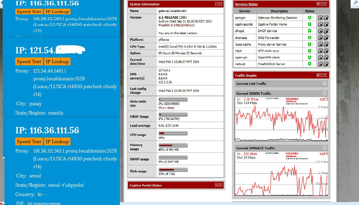

                  Got it working!!! Using Openvpn as Wan2 with Unofficial Lusca proxy. Should work with squid.

                    Great and congrats .. Actually pfSense 2.1 is not stable for me sometimes it works, after reboot it does not work, a few hours later it works, sometimes it do not work.  :'( :'(

                      @Kababayan:
                      The simple Question is, How did you achieve this goal?
                      Please share your knowledge with us!
                      greetings Oli
