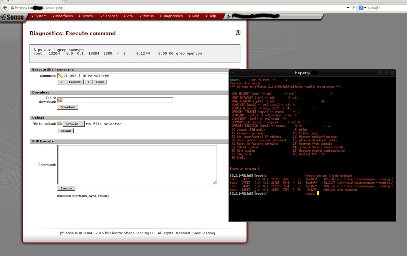

                  • H Offline
                    heper
                    odd.png_thumb
                      macralf
                      The reason it doesn't work in the GUI is it doesn't see "openvpn" with the grep because the buffer isn't holding enough characters.  If you run the command on the physical console, you'll get the same results.  In SSH you can see more characters horizontally, so the grep can see the "openvpn".
                      If you run the command without the u, you can see it in the web console.  ps ax | grep vpn
