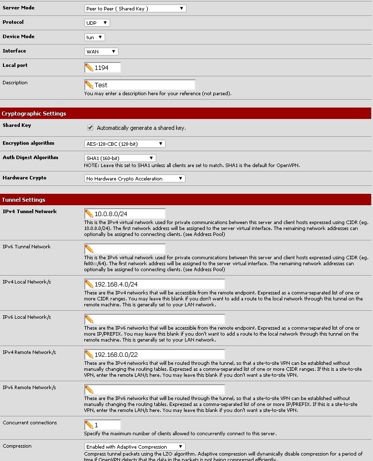

      After following the following guide, my web configurator is consistently returning a "503-Service Not Available."  If I reboot pfSense I can login initially but after a little while I get the error message again.  Not only is pfSense inaccessible via the web gui, but I also lose connectivity via IPMI on my LAN even though I can ping the IPMI address.
      I restored a backup to an earlier config and everything is fine after that.  Tested configuring again and as soon as I configure the OpenVPN server (and nothing else) I get the same issue witht he web configurator being inaccessible.
      What am I missing?

        What are your interface subnets, your OpenVPN tunnel network subnets, and any OpenVPN remote networks.  Please include netmasks.

                                That is what you have defined as the remote networks for the OpenVPN server.  Why is the same route on a local interface?  What is 192.168.4.10?

                                        I know something is configured wrong on my end, I don't believe it's a bug anymore which was why I changed the title of my thread.
                                        192.168.4.10 is a gateway to my Verizon Actiontec "router" (with a router of 192.168.0.0/22) configured on my pfSense box which has an IP address of 192.168.4.1.  192.168.4.10 WAS the IPMI address but before I had configured that gateway, I forgot I had changed it.  Just to clarify:
                                        192.168.4.1: LAN address of pfSense box
                                        192.168.4.10:  Gateway address to Actiontec router (old IP for IPMI)
                                        192.168.4.250:  Current IPMI address
                                        I realize it looks bad that my old IPMI address and the address for the gateway to my Actiontec are the same but I can assure they are not currently configured to be the same.
                                        To further confirm a that conflict not being the problem I unplugged my IPMI, and removed the 192.168.4.10 gateway along with the 192.168.0.0/22 route for it from pfSense and still have the same issues once I enable OpenVPN.
                                        What would you like me to show display to show that being the case?  Remove them again and do another netstat -r?
