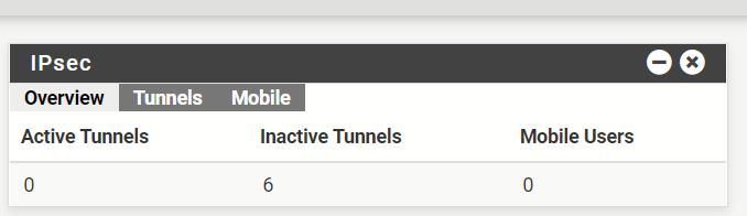

  • 2.5.1 (from 2.4) and status widget not working
    245 Views
    JRubenCJ
    The moment the other tunnel came up (we have 2 in that firewall) the widget began to show the correct information. But not while only one of them was active.
