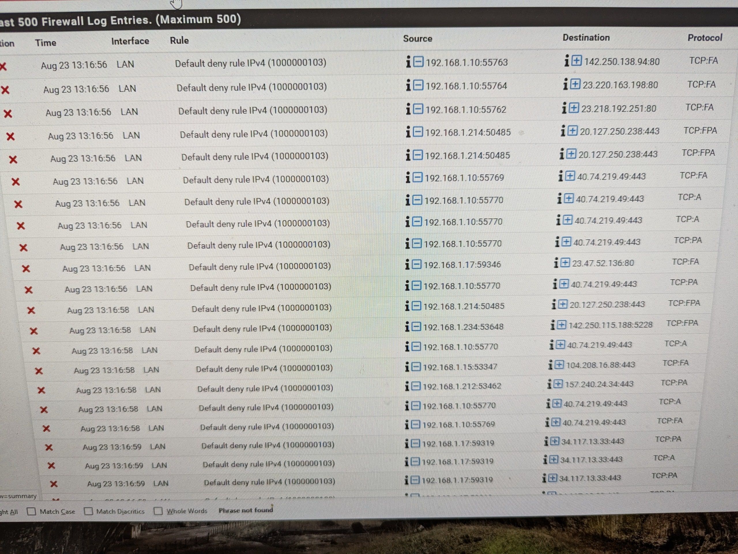

• Recurring Default deny rule IPv4(1000000103)
    14
    14 Posts
    @rwarnken as @Gertjan mentions, turning off logging of the default deny can be helpful for keeping your logs less busy. I have it off, and just have the stuff I am interested in logging per settings on the rules, etc. If you run into something not working and you need to troubleshoot to see if say its being blocked by default deny, turning it back on is just a click away.
