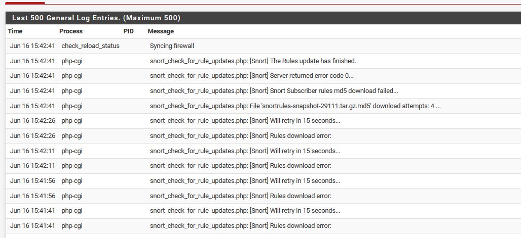

• Snort ruleset update causing firewall to crash/reboot
    I think I may have found the problem by uninstalling snort and trying suricata: After installing suricata, same problem happens. Then I tried an older version of the snort rules: snortrules-snapshot-29110.tar.gz works snortrules-snapshot-29111.tar.gz causes firewall to crash! So, something is definitely wrong with the pfSense code... a content update should not crash the firewall!
