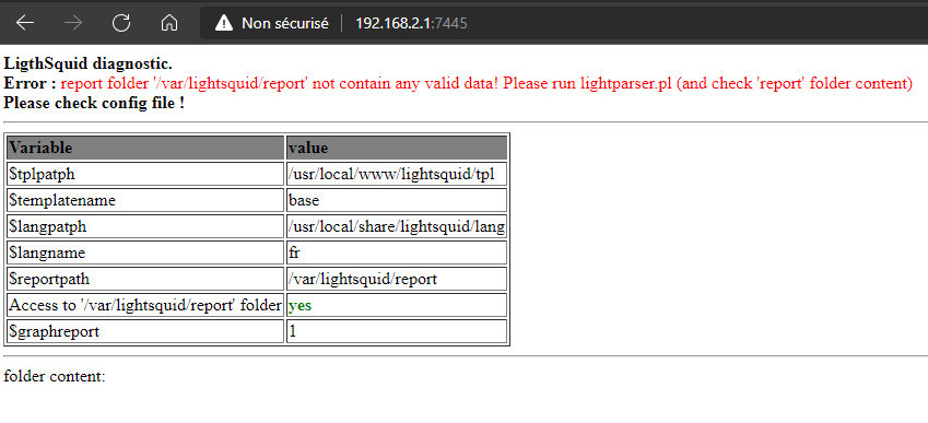

  • Lightsquid: report error
    552 Views
