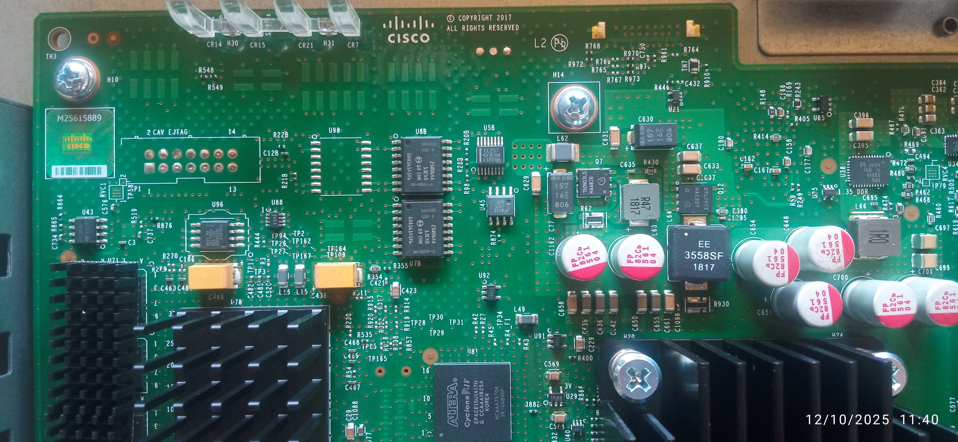

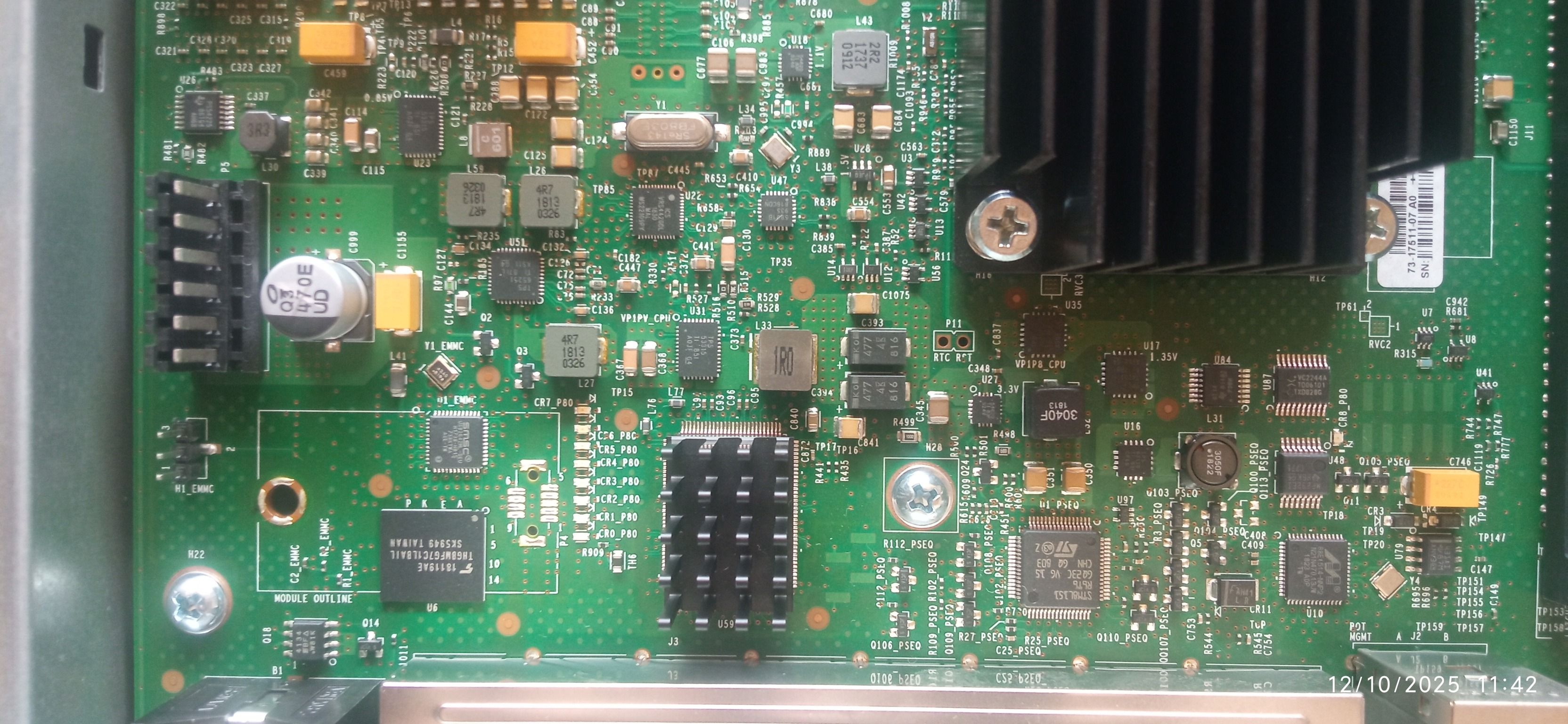

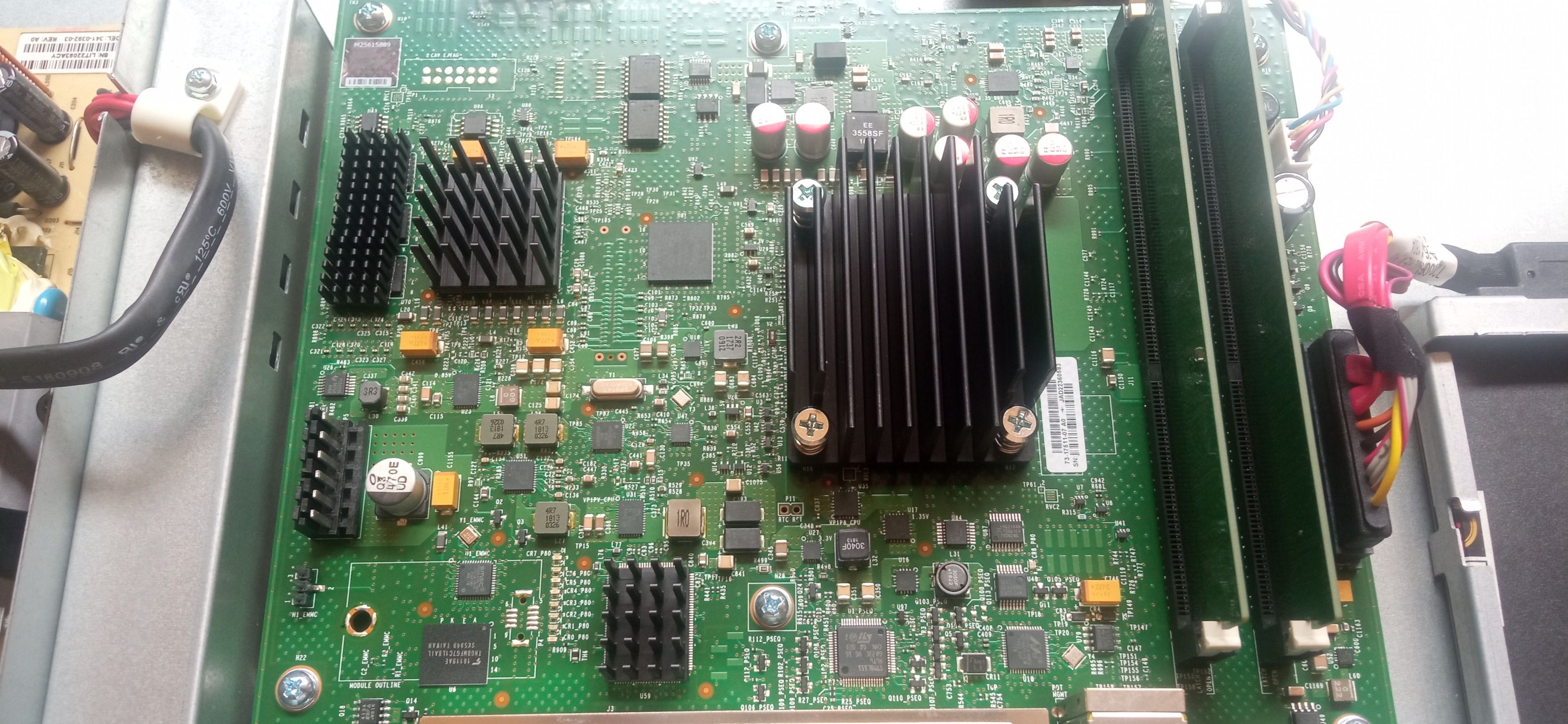

      1. Opened the machine, looked for the VGA pinout, but it wasn't there.
      2. Accessed the console, but I'm having trouble with ROMON, and I'm confused about how to disable ROMON.
      Attachment: Photos that might be useful
      Please help me.

            Mmm, I've never poked at one of those. It may not have anything below rommon, like uboot etc. In which case you would need to either create an image that rommon will will accept or replace rommon with ome other bootloader/BIOS. Both of which are non-trivial!
            It may have a second console header that shows more/different output.

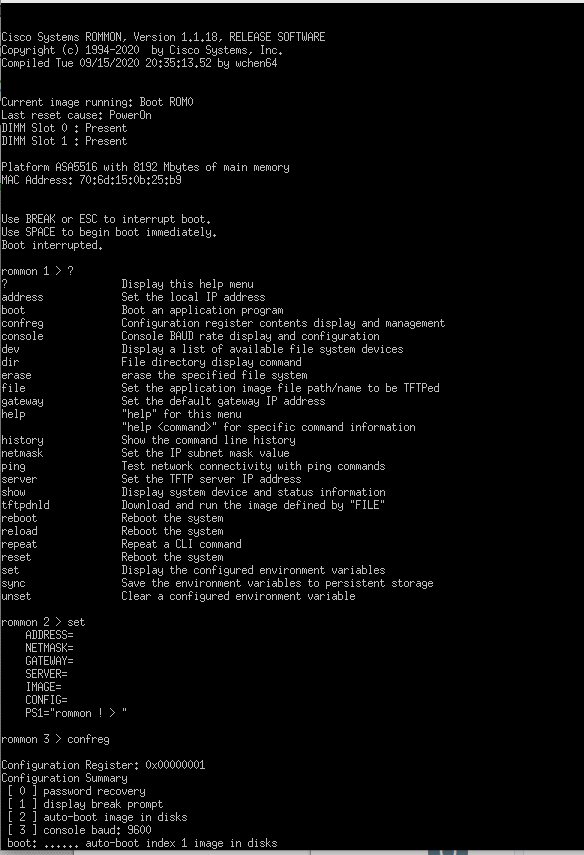

                m782 @patient0
                @patient0
                Yes, I've done it before, but I'm confused about what to do.
                This is the result.
                Cisco Systems ROMMON, Version 1.1.18, RELEASE SOFTWARE
                Copyright (c) 1994-2020 by Cisco Systems, Inc.
                Compiled Tue 09/15/2020 20:35:13.52 by wchen64
                Current image running: Boot ROM0
                Last reset cause: PowerOn
                DIMM Slot 0 : Present
                DIMM Slot 1 : Present
                Platform ASA5516 with 8192 Mbytes of main memory
                MAC Address: 70:xx:1x:0b:xx:b9
                Use BREAK or ESC to interrupt boot.
                Use SPACE to begin boot immediately.
                Boot interrupted.
                rommon 1 > ?
                ? Display this help menu
                address Set the local IP address
                boot Boot an application program
                confreg Configuration register contents display and management
                console Console BAUD rate display and configuration
                dev Display a list of available file system devices
                dir File directory display command
                erase erase the specified file system
                file Set the application image file path/name to be TFTPed
                gateway Set the default gateway IP address
                help "help" for this menu
                "help <command>" for specific command information
                history Show the command line history
                netmask Set the IP subnet mask value
                ping Test network connectivity with ping commands
                server Set the TFTP server IP address
                show Display system device and status information
                tftpdnld Download and run the image defined by "FILE"
                reboot Reboot the system
                reload Reboot the system
                repeat Repeat a CLI command
                reset Reboot the system
                set Display the configured environment variables
                sync Save the environment variables to persistent storage
                unset Clear a configured environment variable
                rommon 2 > set
                ADDRESS=
                NETMASK=
                GATEWAY=
                SERVER=
                IMAGE=
                CONFIG=
                PS1="rommon ! > "
                rommon 3 > confreg
                Configuration Register: 0x00000001
                Configuration Summary
                [ 0 ] password recovery
                [ 1 ] display break prompt
                [ 2 ] auto-boot image in disks
                [ 3 ] console baud: 9600
                boot: ...... auto-boot index 1 image in disks
                do you wish to change the configuration? y/n [n]:
                Rom image verified correctly
                Do you have any good ideas?
