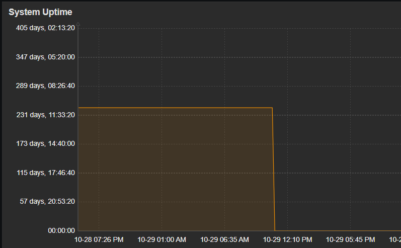

                      Prior to reboot i did have an uptime of 231 days. I dont remember how long the uptime was for the 24.11 issue but this firewall doesnt get rebooted often.

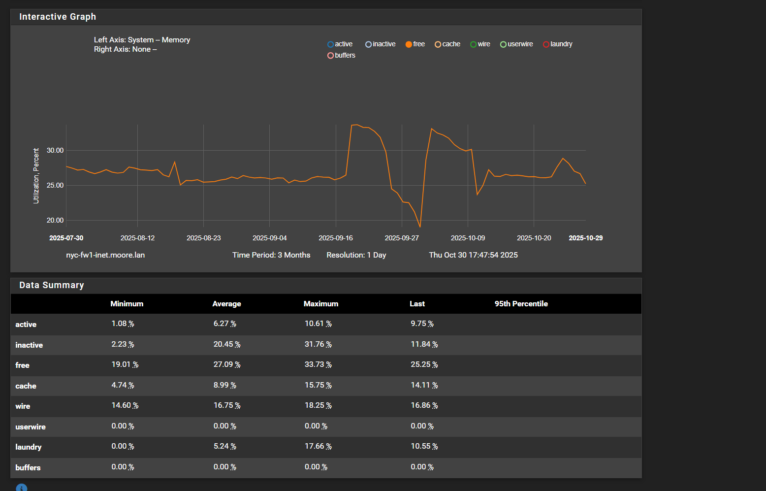

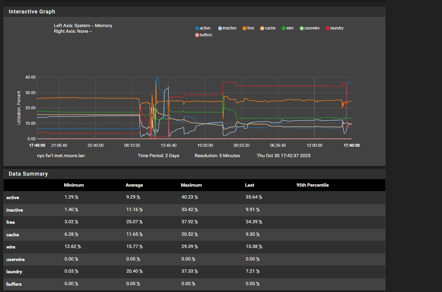

                        Check the memory RRD graphs. If there was a leak it should be pretty obvious.
                          I dont know specifically what to look for but do you see anything unusual?

                            You would at least see free memory decreasing over time. Check a longer date range that includes up to the upgrade.
                              @stephenw10 Here is 3 months. Besides the very strange drop in September it seems...normal?
                              Wireless: Unifi, Aruba IAP
                              JNCIP,CCNP Enterprise
                                Yeah no obvious leaks there.
                                  @stephenw10 curious as to what your testing will reveal. keep me posted!
