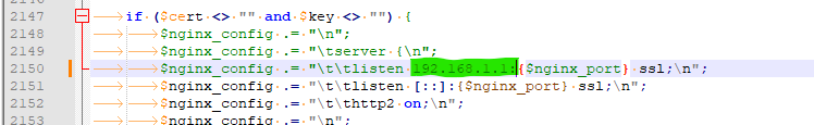

                            Gertjan @truist
                            @truist
                            Here's the gun and a bullet :
                            Add the LAN IP right here :
                            Btw : the ssl (port 443 normally) nginx will be 'locked' to the LAN IPv4 - as you can it still listens on all IPv6 interfaces.
                            Further down you'll find the place where you can do the same thing for the http (non-ssl) access.
                            I didn't test this.
                            The file is : /etc/inc/system.inc
                            Happy hunting 😊
