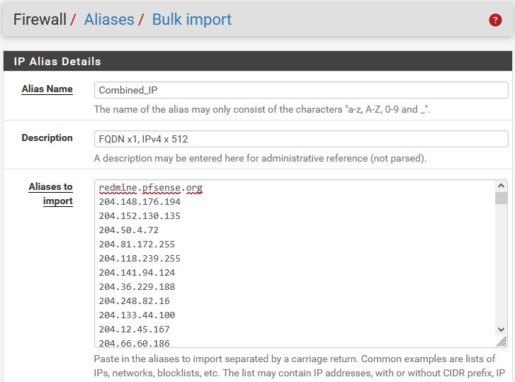

                                  Reload the baseline configuration and enter the a 513 element alias such as the following, -> 514 elements are shown in the corresponding alias table

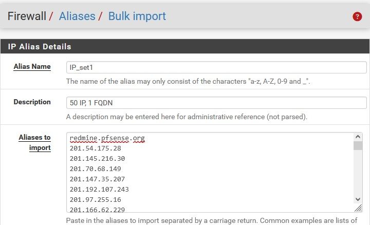

                                  Enter Alias like IP_set1 with 50 IP + FQDN x1 as shown below -> 52 records in Alias table
                                  Enter Alias like IP_set2 with 50 IP + FQDN x1 using the same method (mine started 202.) -> 52 records shown in the alias table

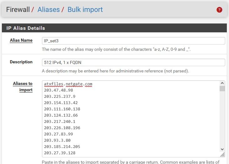

                                  Now again try and enter IP_set3 with 512 IP + FQDN x1 as shown below -> zero records. After several filter reloads 271 records. Waiting longer, Filter reload and "killall filterdns" all make no difference.
                                  Which contrasts with the 514 records when no other aliases were entered.
