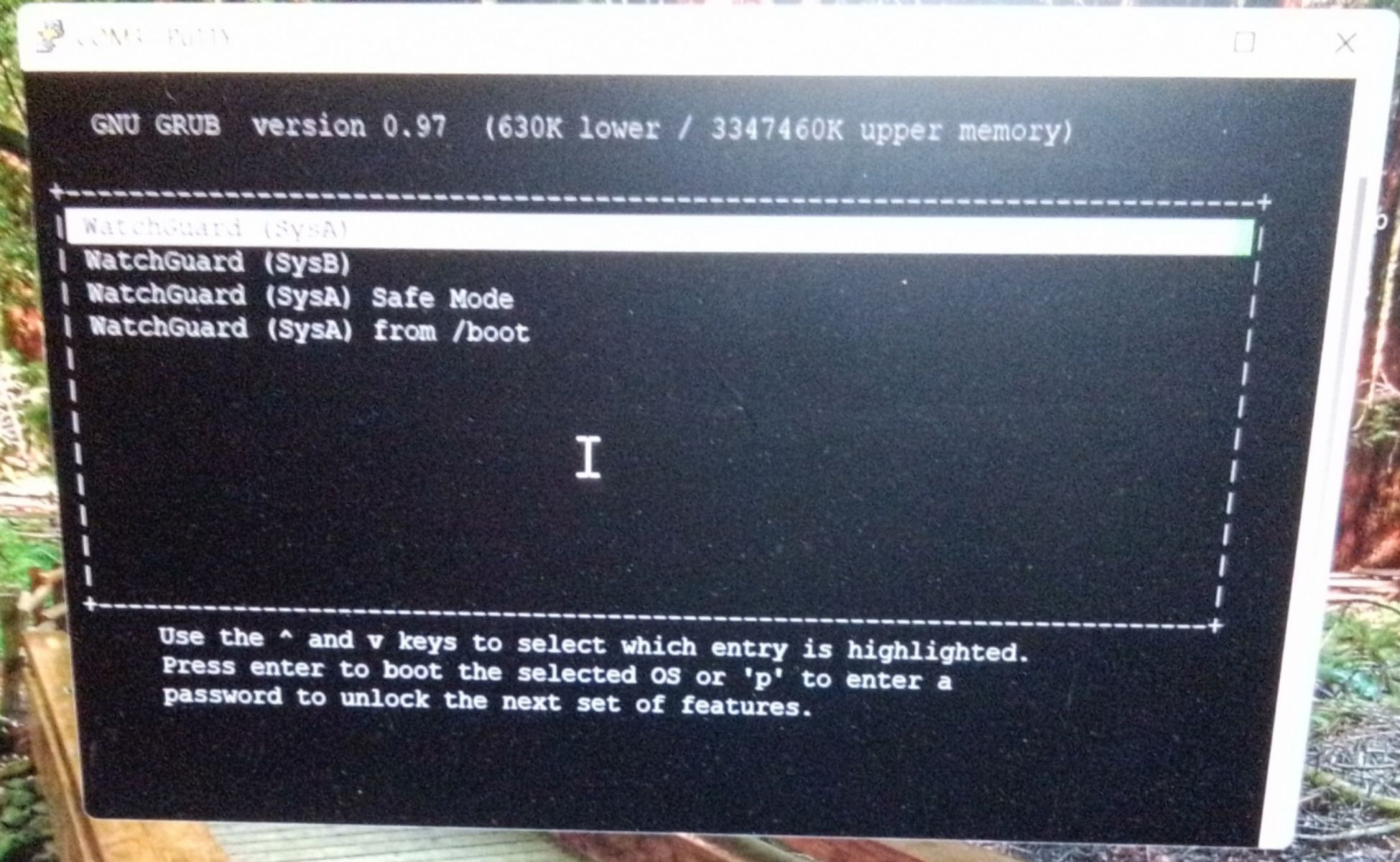

      Today I got a M400 box, before I start doing any modifications I wanted to see if I could get some info by logging into the box through the serial connection or by the web browser. I wasn't able to access it by the browser connecting to the port #1 . I was expecting my computer will get an IP in the network 10.0.1.xxx but it didn't happen. So I set it up manually with IP 10.0.1.99 once done I used the browser to point to 10.0.1.1:8080 no joy.
      I used the serial connection which worked well, what I got, I was not expecting. Choosing any of the options I was asked to login so I used admin as user name and [admin edit] as the password, I got wrong login.
      I am curious cause I thought I could get into the BIOS and see the hardware info without opening the box. Any suggestions in how I could get into the BIOS?.... I am including a pic I took.
        jriofrio @jriofrio
        • stephenw10S Online
          If you want to login to the WG OS you can probably use admin/readwrite. But that's only if it's been reset.
          The BIOS password (which I removed) only applies for the BIOS not at grub or at the booted WG-OS. To access the BIOS hit 'TAB' at the serial console after powering on when you see:
          Version 2.15.1236. Copyright (C) 2012 American Megatrends, Inc.
          WG-M400 Ver.AR6 11/16/2019
          Press <DEL> or <ESC> to enter setup.
          Tab key on remote keyboard to enter setup menu, and key 'o' for popup menu.
          Though that's from an updated box.

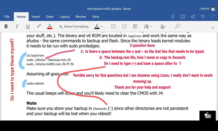

              I need your help to clarify something for me updating the BIOS. Your instructions for updating the BIOS I would like to follow, just need a little clarification.
                Those are not my instructions. When I did it I used FreeDOS and afudos.
                1. Yes there is a space there.
                2. I assume that's in OpenWRT where in squashfs only the users home directory is backed up. ~ is a shortcut to /home/user for any user.
                But you don't have to upgrade the BIOS at all. You can just boot pfSense and use it.
                  Oh right it's TinyCore, hence the /tc link!
                  I'd forgotten that entirely but I used it for an M500. You can just copy/paste the commands there into the serial console.
