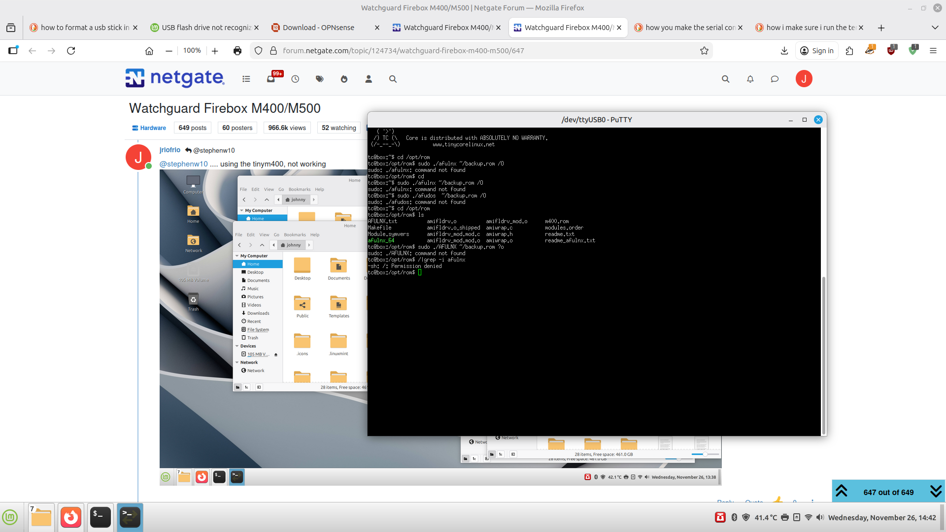

                          jriofrio @stephenw10
                          @stephenw10 .... using the tinym400, not working
                          • J Online
                            jriofrio @jriofrio
                            I have tried many different ways in order to make afulnx to run but it looks like the afulnx app is not present in the image you created... let me know please. I might be doing or typing it wrong....
                            • K Offline
                              korenchkin @jriofrio
                              @jriofrio use tab for autocomplete and ls (-la if you want 1 line for 1 item),maybe find /|grep -i afu (to find afuwhatever,that pipe before grep is on the backslash key on us keyb, -i ignore case)
                              • J Online
                                jriofrio @korenchkin
                                @korenchkin .... I tried what you said.... I got this
                                • J Online
                                  jriofrio @jriofrio
                                  i am not sure what you meant with use TAB to autocomplete... my bad, i didn't include find and now i got a long list of files
                                  • K Offline
                                    @jriofrio i see you have no background in dos :)
                                    i can clearly see afulnx_x64 (or something similar,half-hidden under message now),so use that info, tab is for when you write afu and press "tab",it will autocomplete if there are no 2 afuaa and afubb...if there are,after second tab it will list all options and you need another letter...if no autocomplete,you might have wrong path...
                                    • J Online
                                      @korenchkin yes, you are correct... i run the commands including the _64 and it worked.... thank you very much for your help... im happy now.
