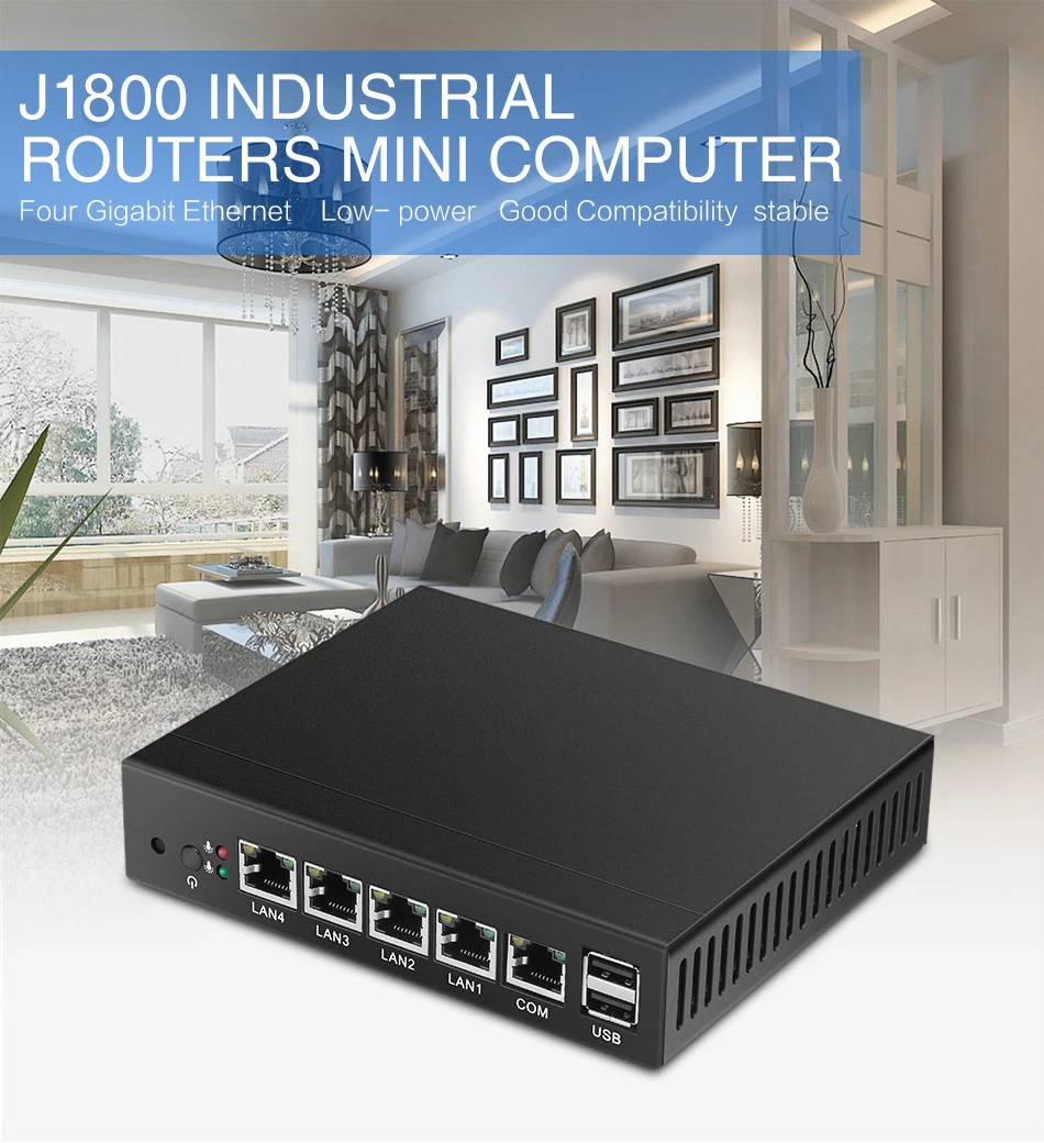

      Hi, pfSense newbie here with a question regarding my choice of hardware.
      I just setup one of these mini pc computers with the 4 network ports, running on a J1900 CPU and have a question as to whether it's running too hot between 66-72 degrees Celsius? There's no CPU fan and this case is all smooth (unlike the Qotom's with the radiator fins).

          Very toasty indeed. Especially where that is probably idle. I was actually surprised at the picture you posted as that proc should not go into that type of chassis, it just isn't masde for that. Qotom as you said passes that ambient heat to the radiator fins which is why they can get away with passive cooling in a lot of their products. Put it this way my j1900 runs at about 28c though I will say mine is in a basement that stays rather cool all year at around 68F

            Did you enable PowerD? Also, as the others posted, that case doesn't suit the SoC.
              Link LEDS on the console port don't inspire confidence. Unless they are really wired to show serial activity….

              Is it using the case as a heatsink? Is it connected correctly?
