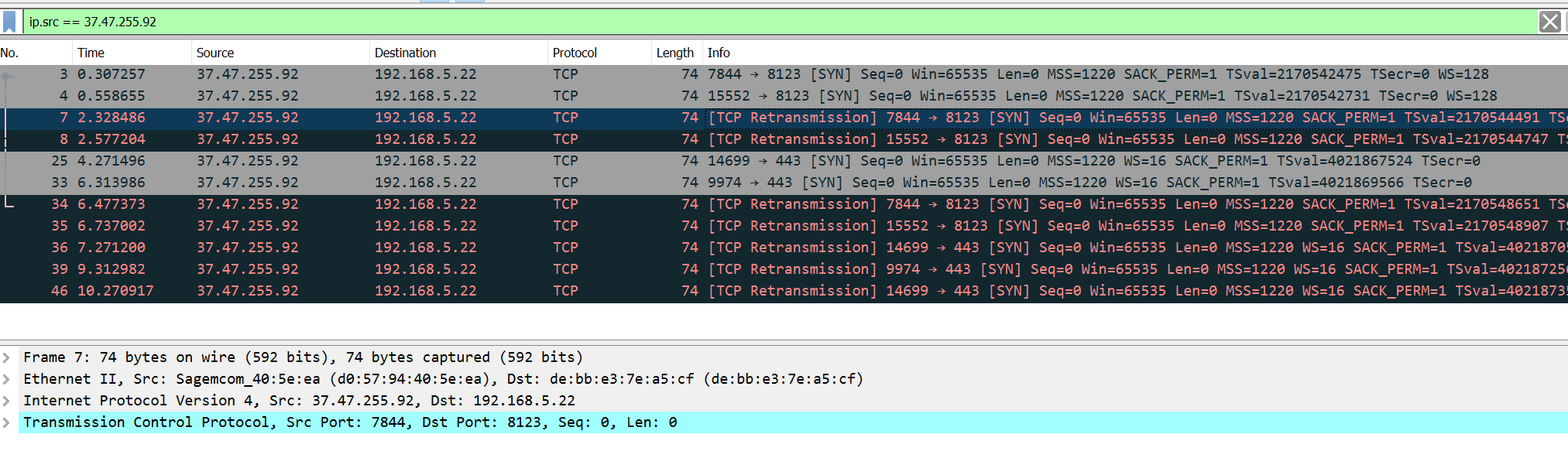

                • F Offline
                  franky29 @g146m026
                  @g146m026 no worries. I'm getting a bit further now. I got packet capture from the WAN side and I can see some 443 traffic trying to hit 8123 but getting dropped. 2020-03-18_2318.png
