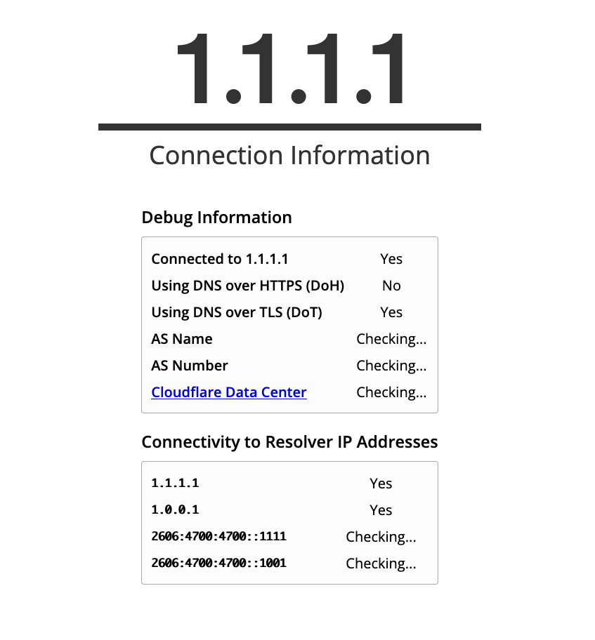

                  bldnightowl @chudak
                  And while I'm seeing DoT working now, that Cloudflare page takes a long time to come back with answers for AS Name, AS Number and the Cloudflare Data Center -- and eventually indicates that it has no connectivity to Cloudflare's IPv6 resolver IP addresses.
