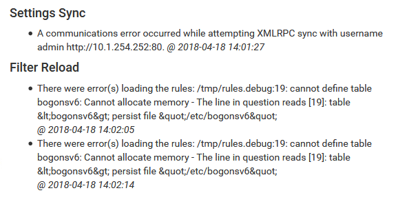

      Hello,
      Is It possible use CARP on NanoBSD ?
      I did it but I always have an error message while on a freeBSD, I use the same procedure and everything works perfectly.
        Yes. NanoBSD should make no difference to CARP/HA.
        That first error shows it can't connect to the Secondary for some reason. admin login is wrong maybe or no firewall rule on the sync interface to allow it.
        That second error can be corrected by setting 'Firewall Maximum Table Entries' to 400000 in System > Advanced > Firewall & NAT.

          Can you tell me what these error messages are, please ?
            Sorry missed your screenshot. Edited while you replied.  ;)
              Morkall
              Here  ;D
                Morkall
                "That second error can be corrected by setting 'Firewall Maximum Table Entries' to 400000 in System > Advanced > Firewall & NAT."
                This corrected my two problems! thank you very much  ;D ;)
