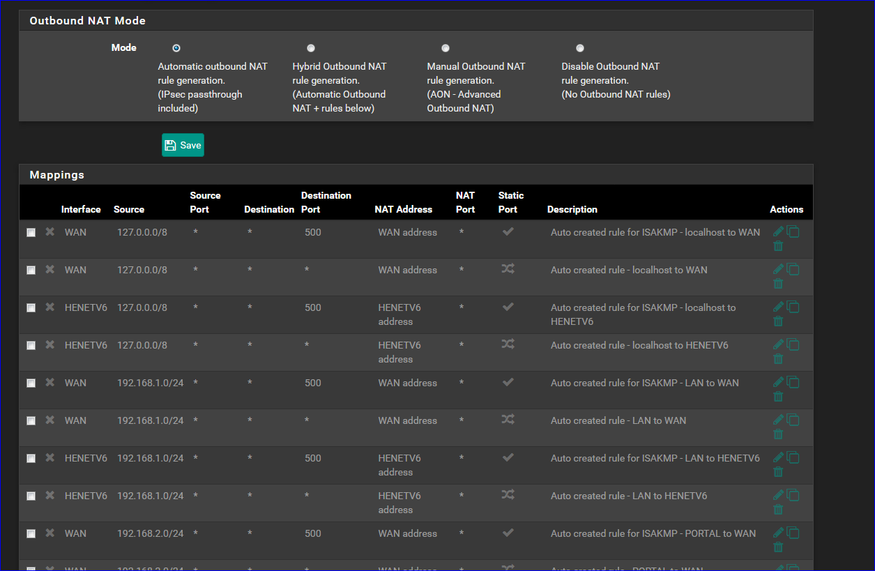

                            Can we see your full outbound NAT page?
                            beremonavabiB 1 Reply Last reply Reply Quote 0
                            • beremonavabiB Offline
                              beremonavabi @stephenw10
                              SG-4860, pfSense 2.4.5-RELEASE-p1 (amd64)
                                Hmm, looks OK. And you're using manual mode there or hybrid?
                                The the WAN the default gateway on your system?
                                Is default gateway switching enabled?
                                I could imagine NTP trying to use the VPN gateway and sourcing from something not NAT'd there. It should always use the default gateway though.

                                  Manual mode and, yes, the WAN is the default gateway. Default gateway switching is OFF under System > Advanced > Miscellaneous.
                                  In normal operation, everything is on the VPN_LAN interface (192.168.20.0/24). My firewall rules for that are:

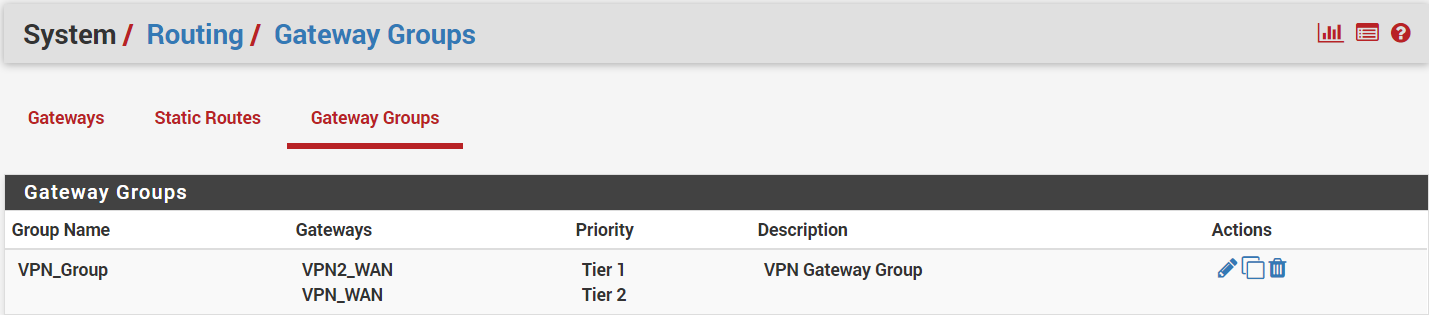

                                      Still not working without WAN selected in Settings > NTP. For posterity, here's some information on my gateways:
                                      RW_VPN is my VPN server, VPNx_WAN are my two VPN clients, IPv6 is off so all the IPV6 gateways are disabled, and I've scribbled over my WAN_DHCP addresses for privacy purposes.
                                      I've also got a Gateway Group:
