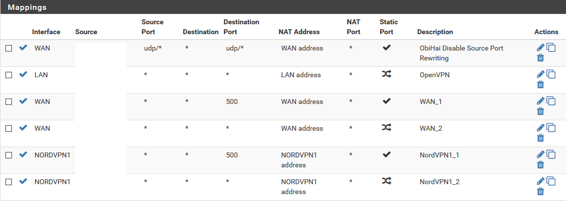

    I have a network with some clients on the 192.168.1.0/24 segment, and I want to direct certain clients through the OpenVPN I have setup. I have a functioning OpenVPN client on the pfSense system and it shows as up.
    I attempting to follow a variety of tutorials, which basically consist of turning on an interface for the OpenVPN which has no IP of it's own. Turning on the IPv4 gateway dynamically provided via the providers OpenVPN config. And setting up Pass rules in the interface which holds the IPs (LAN in this case), with an alias for the clients I want to pass to OpenVPN with that gateway set in the advanced options. And below that having the regular LAN to any rule.
    I also have on the NAT setup a mapping from the LAN subnet to the OpenVPN address.
    Clearly I am doing something wrong, since it's not working. Every client is just fine except the one I'm testing this on to VPN with and it gets name resolution and all that sort of thing just fine, but it cannot ping the gateway or anything outside of the network either.

          I could be completely wrong, but from your outbound NAT rules it appears to me that your VPN provider is assigning IPs on the same network (192.168.1.0/24) as your LAN. And if that's true, I would imagine you'd have a bad time. While there may be other mitigation strategies for this (possibly 1:1 NAT, but I'm not really familiar with it), the easiest thing may be to change your LAN network to something else, like 192.168.0.0/24.

              Thanks, what in particular do you need to see? According to PIA they use port 1194 normally. The only firewall involved is the pfSense one.
              @TheNarc I don't believe so, though I am unsure how to tell what IPs they're assigning. I think at one point I saw a 10.x.x.x IP assigned to the gateway itself which I assume had come from PIA.

                @grimm-spector Okay, well that would make more sense; I think that's a more common range for VPN providers to use. However, then maybe you're missing the outbound NAT rules you need? I didn't see any for 10.x.x.x sources. You should have entries like the two bottom ones in the following image (IPs removed) for each VPN interface you have:

                  Nope, I have those, using the source as the LAN subnet, where the hosts are all situated, with the NAT address as the VPN address and the interface as the VPN interface. This is in the Outbound section, correct?
