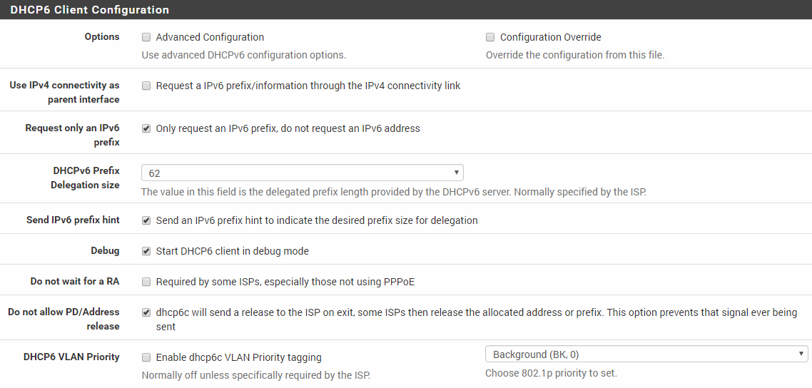

    These are the settings:
    Blocking bogon and private networks is unchecked (for now).

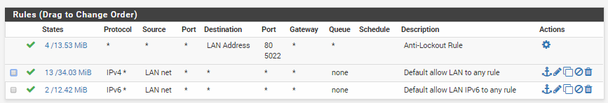

    Firewall rules:
    WAN
    LAN

        Okay, my Interfaces are:
        igb0: WAN
        igb1: LAN
        First there is this block:

        Jun 7 10:10:08	dhcp6c	13806	picked a server (ID: 00:03:00:01:00:22:zz:zz:zz:zz)
        Jun 7 10:10:08	dhcp6c	13806	Sending Request
        Jun 7 10:10:08	dhcp6c	13806	a new XID (66e2a7) is generated
        Jun 7 10:10:08	dhcp6c	13806	set client ID (len 14)
        Jun 7 10:10:08	dhcp6c	13806	set server ID (len 10)
        Jun 7 10:10:08	dhcp6c	13806	set elapsed time (len 2)
        Jun 7 10:10:08	dhcp6c	13806	set option request (len 4)
        Jun 7 10:10:08	dhcp6c	13806	set status code
        Jun 7 10:10:08	dhcp6c	13806	set IA_PD
        Jun 7 10:10:08	dhcp6c	13806	send request to ff02::1:2%igb0
        Jun 7 10:10:08	dhcp6c	13806	reset a timer on igb0, state=REQUEST, timeo=0, retrans=1024
        Jun 7 10:10:08	dhcp6c	13806	receive reply from fe80::yyyy:yyyy:yyyy:yyyy%igb0 on igb0
        Jun 7 10:10:08	dhcp6c	13806	get DHCP option server ID, len 10
        Jun 7 10:10:08	dhcp6c	13806	DUID: 00:03:00:01:00:22:zz:zz:zz:zz
        Jun 7 10:10:08	dhcp6c	13806	get DHCP option client ID, len 14
        Jun 7 10:10:08	dhcp6c	13806	DUID: 00:01:00:01:22:xx:xx:xx:xx:xx:xx:xx:xx:xx
        Jun 7 10:10:08	dhcp6c	13806	get DHCP option opt_82, len 4
        Jun 7 10:10:08	dhcp6c	13806	unknown or unexpected DHCP6 option opt_82, len 4
        Jun 7 10:10:08	dhcp6c	13806	get DHCP option DNS, len 16
        Jun 7 10:10:08	dhcp6c	13806	get DHCP option domain search list, len 5
        Jun 7 10:10:08	dhcp6c	13806	get DHCP option IA_PD, len 18
        Jun 7 10:10:08	dhcp6c	13806	IA_PD: ID=0, T1=0, T2=0
        Jun 7 10:10:08	dhcp6c	13806	get DHCP option status code, len 2
        Jun 7 10:10:08	dhcp6c	13806	status code: no prefixes
        Jun 7 10:10:08	dhcp6c	13806	dhcp6c Received REQUEST
        Jun 7 10:10:08	dhcp6c	13806	nameserver[0] fe80::yyyy:yyyy:yyyy:yyyy
        Jun 7 10:10:08	dhcp6c	13806	Domain search list[0] lan.
        Jun 7 10:10:08	dhcp6c	13806	make an IA: PD-0
        Jun 7 10:10:08	dhcp6c	13806	status code for PD-0: no prefixes
        Jun 7 10:10:08	dhcp6c	13806	IA PD-0 is invalidated
        Jun 7 10:10:08	dhcp6c	13806	remove an IA: PD-0
        Jun 7 10:10:08	dhcp6c	13806	reset a timer on igb0, state=INIT, timeo=0, retrans=557
        Jun 7 10:10:08	dhcp6c	13806	executes /var/etc/dhcp6c_wan_script.sh
        Jun 7 10:10:08	dhcp6c		dhcp6c REQUEST on igb0 - running rc.newwanipv6
        Jun 7 10:10:08	dhcp6c	13806	script "/var/etc/dhcp6c_wan_script.sh" terminated
        Jun 7 10:10:08	dhcp6c	13806	removing an event on igb0, state=REQUEST
        Jun 7 10:10:08	dhcp6c	13806	removing server (ID: 00:03:00:01:00:22:zz:zz:zz:zz)
        Jun 7 10:10:08	dhcp6c	13806	got an expected reply, sleeping.

          @terabit said in IPv6 Track Interface doesn't work - static IP works:
          Jun 7 10:10:07 dhcp6c 13806 status code: no prefixes
          You might be asking for a /62 but they aren't giving one so there is nothing for the system to add to the tracked interface.

            I can capture those packages on WAN:
            Shouldn't this be a sign that I actually get a /62?
            Or am I missing something?
              Try different Prefix Delegation size. Instead of 62 try 60 or 56.
              I have noticed that pfsense won't work at all if it doesn't match what the ISP is actually providing.
              I was testing different router packages with ipv6 about a few months ago and initially I couldn't get pfsense to work because I thought my ISP provided a /60.
              I tried a Mikrotik router and it worked, and what I saw was that even though I asked for the /60, the Mikrotik somehow figured out that the ISP was providing a /56 and it configured itself to work that way.
              So I went back to the pfsense and put in 56 for the prefix delegation size and then it worked. It doesn't do the auto negotiation for the prefix at least with my ISP.
                I already tried all possibilities (with reboot, etc.) and I can only get a /62.
                I also confirmed this is the "correct" choice with an ISP engineer. (They will assign /56 later, btw.)
                The problem is:
                The Track Interface does not work, I won't get an IPv6 on LAN with that.
                But when I request a 62 and use the 2003:xxxx:xxxx:201c:: prefix as a static IPv6, everything works.
                The packet captures also seem to confirm that can I request /62 and actually get the /62 prefix.
                So the problem seems to lie on the pfSense Track Interface side of things, either me making a mistake or some kind of bug/compatibility issue.
                Or did I miss something?
                Thanks for your time and effort, by the way.
