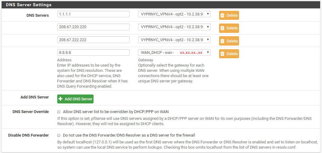

      Here is my GUI DNS server settings. I have played with "DNS Server Override" and "Disable DNS Forwarder" no difference.
