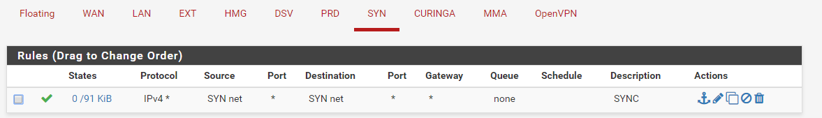

      Both firewalls have the same Installed Packages. Same versions. SYNC interfaces ping each other.
      SYNC interface Rules:
