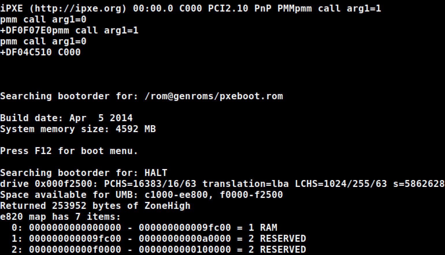

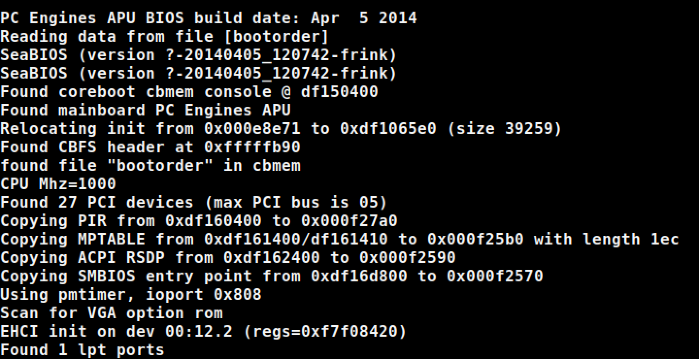

      I was able to get a serial console going and it looks like the last line is stuck on
      /boot/config: -S115200 โ€“D (see screen shots below for further details)

        Is your serial client set for a speed of 115200?
        If you let it go, does it eventually boot up and let you connect over the network?
        Where it stops is where it would usually switch to whatever console settings were present in the loader config, so maybe it doesn't match your client in some way.

          Yes on the speed, although its a bit of a hack since I'm using Linux in a virtual machine. I have let it sit for a while (20 + minutes or so but nothing). What happened after the upgrade was the the GUI page never returned back from trying to reboot.
