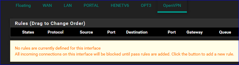

            I kept my "OpenVPN" interface - auto-created when creating a VPN server - empty, no rules.

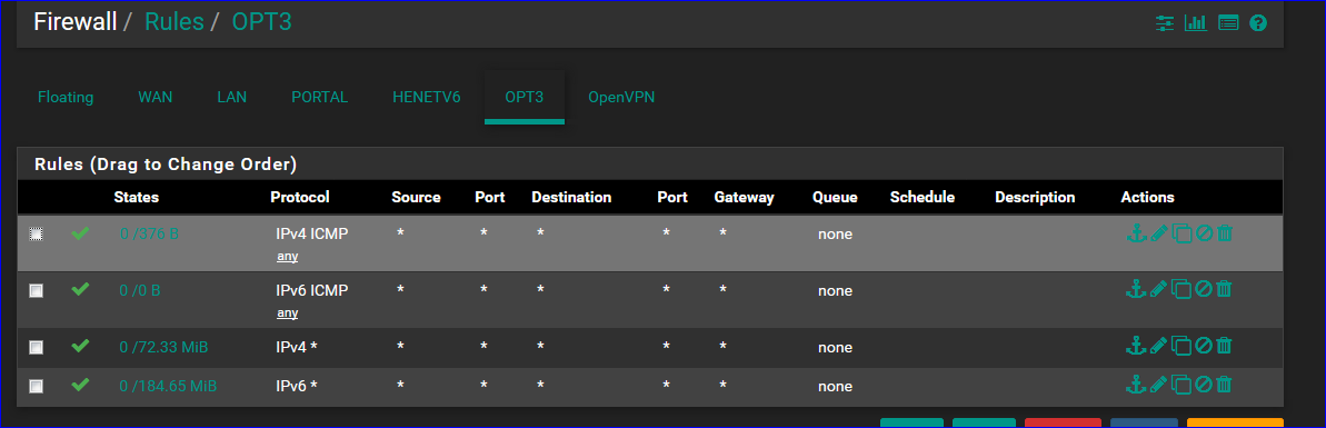

            I was able to create ne new interface OPT3, using the VPN server instance :
            And could add rules to this interface - which can be 'seen' and 'used' by packages :
