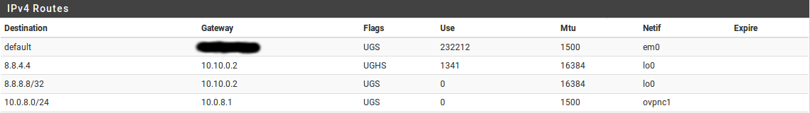

Static route via VPN interface binds to lo0 when created from web page, but binds to tun1 when created from command line.
I have an OpenVPN client on pfSense server up and running. I have assigned a custom interface OPT1 and have created a gateway via that interface. When I am trying to create static route using pfSense web interface via this gateway I am getting a route binded to wrong IP address and wrong interface lo0 and of course it doesn't work.
but then I remove this static route from web interface and create right route but via command linesudo route add -net 8.8.8.8/32 10.10.0.1it works fine
What I am doing wrong ? -

Do you have 8.8.8.8 defined anywhere else such as in System > General?
What routes exist for 8.8.8.8 in Diagnostics > Routes?
Are there any ifconfig errors logged in the OpenVPN logs?
It would help if you posted the connection log from the client here.
@derelict Generally I am trying to add route to different (not 8.8.8.8) IP address and it is NOT defined in System>General for sure and there is no routes for it for sure. There is no errors in both server and client logs.
