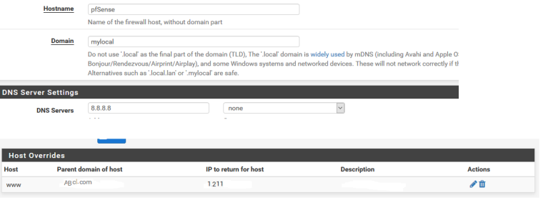

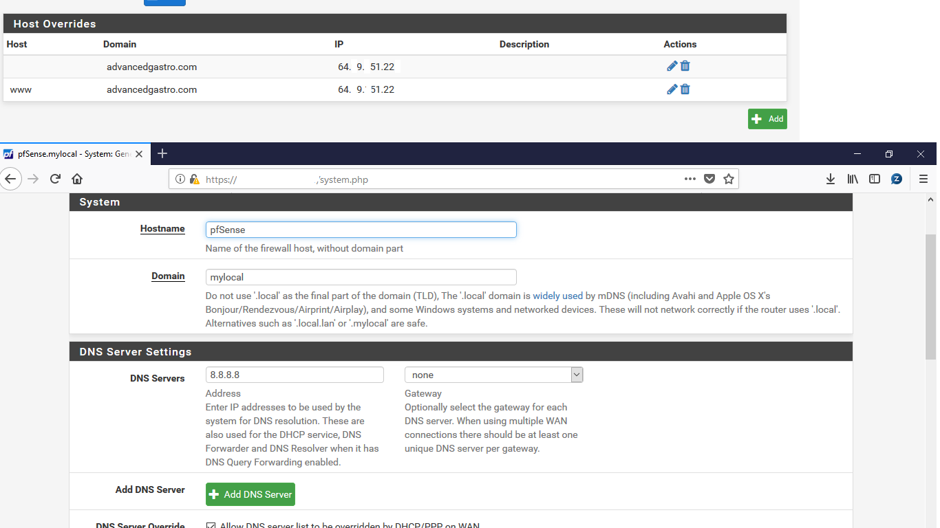

Your domain there is mylocal?? That sure and the F is not public domain.
How about you actually go into what is the problem.. Your domain listed there in pfsense is mylocal which is not a public domain.
but my domain name is same like the website ( internal dns is abc.com and the external site is also abc.com
This is NOT what your showing in pfsense with a single label domain. What exactly is resolving wrong.. You have host.abc.com on the public internet? that resolve to public 1.2.3.4, what exactly is on local network that is resolving wrong?
