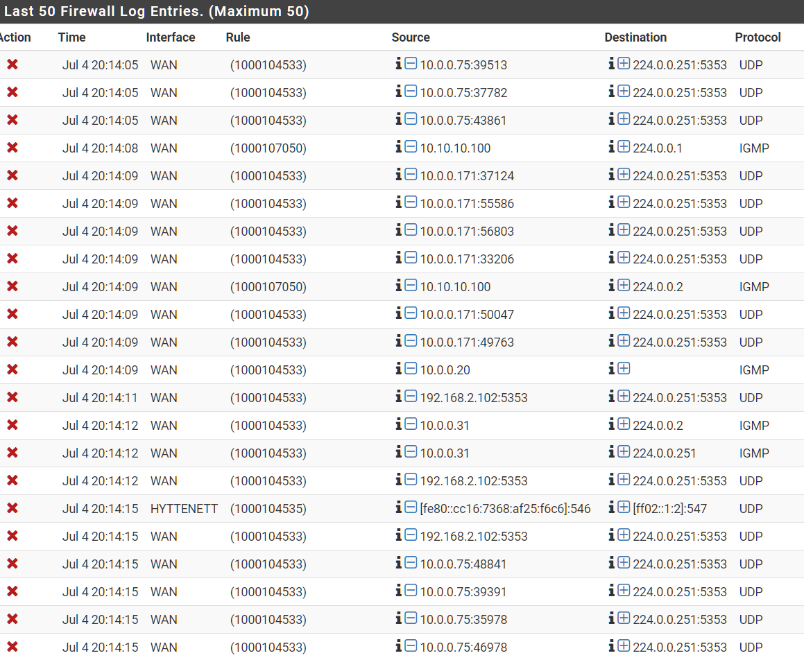

        I have read about the default deny rule, but should it come this often? It just flows in here! 0_1530728257557_e2e0a3a5-6f79-4519-9738-a41b189a740a-image.png
