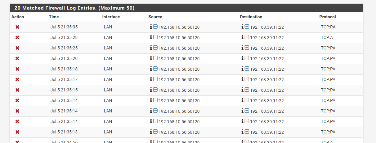

      I have an pfsense box with 3 NICS. WAN,LAN and DMZ. The traffic works as intended, and so does the rules. But after some time, I get disconnected (LAN->DMZ traffic), with TCP:RA,A,PA showed in the firewall logs in pfsense.

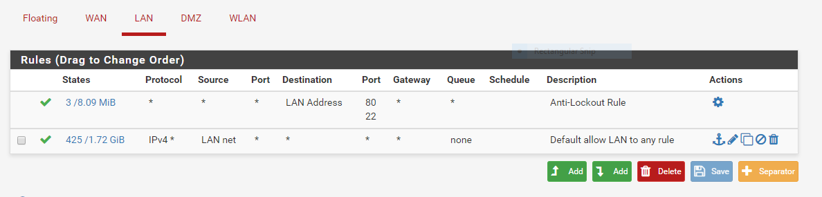

      Rules LAN

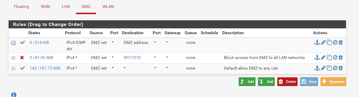

      Rules DMZ

        Those sorts of blocks are normally a sign of asymmetrical traffic.
        Or you could have dupe packets... You understand that first hit you show is RA, or RESET ACK... This basically the client saying F OFF done.. FA would be way to normally close a tcp session. But RA is can be seen sometimes depending on how the client/application is designed..
        Are these devices wireless?
        Once a state is closed, then yeah any other packets that are not SYN would be blocked. A firewall only creates a state with the start of a conversation.. Ie the handshake syn, syn/ack
        So if firewall sees Fin and closes the state, then any other packets still being seen would be out of state and blocked.
        https://www.netgate.com/docs/pfsense/firewall/troubleshooting-blocked-log-entries-for-legitimate-connection-packets.html
