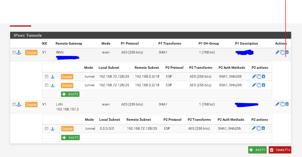

      please note that this device is supporting 2 VPN's which looks like this:
      MAIN BUILDING -----------> FIRST HOP 192.168.73.129/25 -------------> 192.168.157.0 & 192.168.72.129/25SECOND BUILDING

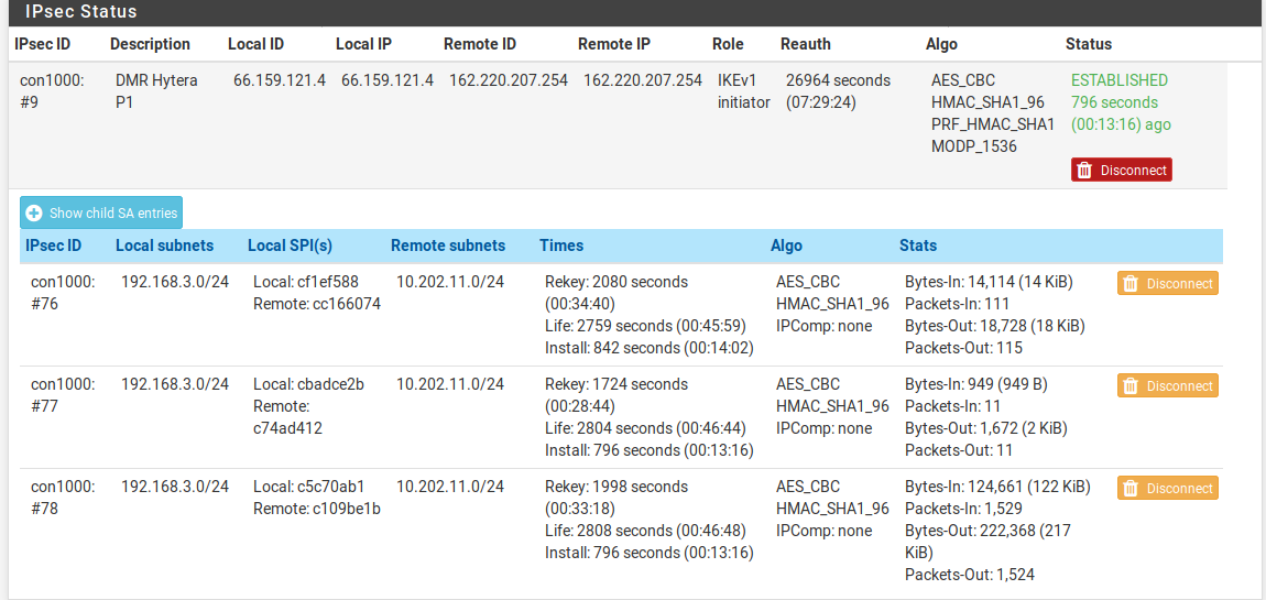

              @harow Same problem. I have one P1 and one P2 connection only, and occasionally, I find multiple 'working' P2 connections when users are complaining about no connection. Reset the connections, and everything is fine.
              I double checked the advanced configuration, and I definitely do not have the "Make before Break" option selected. 0_1549737355937_Multiple_P2.png . The guy supporting the other end (a Cisco RB260) tells me he is not setup for multiple P2's either.

                  The three P2's are all for the same location. I have to drop all three of them for the communications to restart. The failure seems to occur once the P1 has to rekey.
                  And P2
                  Any suggestions?

                          @derelict When checked, all three P2 SA's had increasing packets, so there should have only been one of them at a time.
                            It shows at least 2 most of the time, never seen 3!

                                  What makes it even more strange, look at my image my P2 show -44s etc.
                                  Yours show three P2 all active!
                                  telservT 1 Reply Last reply Reply Quote 0
                                  • DerelictD Offline
                                    Derelict LAYER 8 Netgate
                                    Because they are rekeyed. If the far side continues to use the rekeyed SAs, that's why they are kept around.
                                    What does swanctl --list-sas show?
                                    One INSTALLED two REKEYED?
                                    Look at the logs. Who is requesting those back-to-back rekeys?
                                    They will be in the table until that actual lifetime expires. They will be rekeyed some time prior to that.

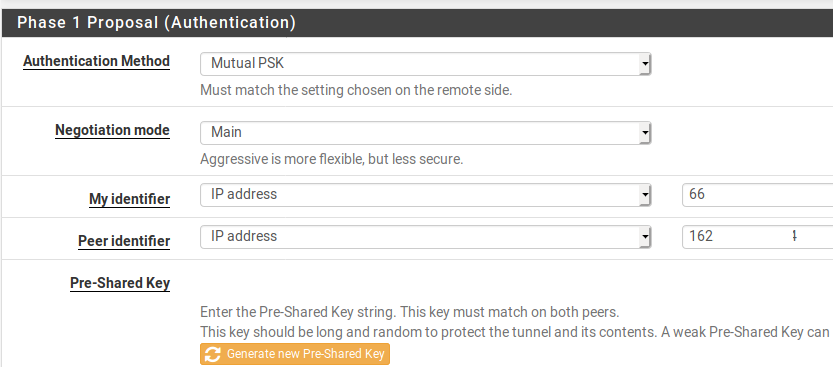

                                      @harow Five days in, and no further problems of multiple P2's. The only thing I've changed is that the P1 is set to not initiate (respond only) to rekey. Will update again if this fails again.
                                      • telservT Offline
                                        telserv @Harow
                                        @harow Thanks for your suggestions on this. The problem hasn't occurred in the past two weeks, after I changed the P1 configuration from Initiator or Responder to Respnder Only.
