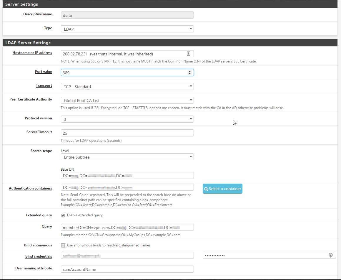

      So I know this has been covered a few times both on here and reddit but I'm still very much struggling to get AD authentication working in pfSense with the primary goal of having my openvpn road warriors connect and be able to use their AD credentials.
      What I would really like to do is have a group called "vpnusers" and only people in that group can authenticate, the trouble is that in my testing the users that can authenticate seems pretty random. It works great with all the users in a single OU but without redesigning my AD layout that isn't going to work in our production environment. Here's my current configuration and with any luck I just need to check a box or something to get this working!

          Its extremely hit or miss when testing from the Diag > Authentication screen or trying to log in to the console, by default pfSense seems to recognize any correct login from the specified authentication containers and if it matches a group created in pfSense like "vpnusers" it will say that the user is part of that group. But its not recognizing all the valid logins and I think its because pfSense is having trouble dealing with my multiple layers of OU's. I have both my Base DN and Authentication Container set to the root of my domain since the users authenticating are from more than one OU.
          Say I have an OU called "test1" that has several users like test11, test12, etc... all of which are members of the vpnusers group and they authenticate just fine. And I have another OU called "test2" with users test21, test22, etc... which are members of the vpnusers group as well but they fail the authentication test.
          I've played with this some more and if I specify an OU as the authentication container it works just fine, to me that verifies my hypothesis that pfSense can't handle the multiple layers of OU's.

              Port 389 is for unencrypted communication. But you have selected a CA? Encrypted communcation is port 696 (I think .. or 698?)
              Consider testing your LDAP communication by using "Softerra LDAP Browser" to make sure things are even accessible before plugging it into pfSense.

                @moikerz : 636 for secured LDAP
                  The selected CA selection is only used if the transport is set to SSL or STARTTLS. So it's doing nothing there.
                  If it was needed I wouldn't expect any queries to work.

                    In that example I gave above about the "test1" and test2" groups they were sitting side by side in the root domain which is why I don't at all understand why one works and one doesn't when my authentication container is the root domain itself. If it see's one OU it should see both right? Unless there's a way to make pfSense do a more detailed query when someone tries to log in I've about decided that this won't work.
                    One thing I have not tried yet because it seems kind of messy to deal with later on down the road is listing each individual OU in the authentication container field. This would be easy to do since it lets you select OU's with checkboxes but if for some reason I ran into a scenario where pfSense couldn't talk to AD and I couldn't pull up that list of checkboxes it would be hell to sift through all that data in that tiny field if an OU got deleted or something screwing the whole thing up. Hopefully that makes sense....
