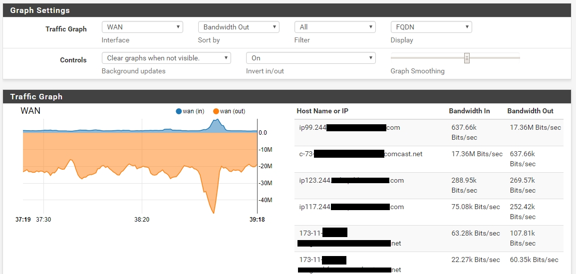

    When I run a speedtest on a server behind the pfSense, I can see that the limiter is active and "slowing" down the outbound throughput. But when I watch the traffic graphs for WAN I can clearly see my outbound going above 20Mbps.
    In this particular example I turned the limiter down more to a measly 10Mbps just to be sure I wasn't getting spikes and then the limiter catching up.

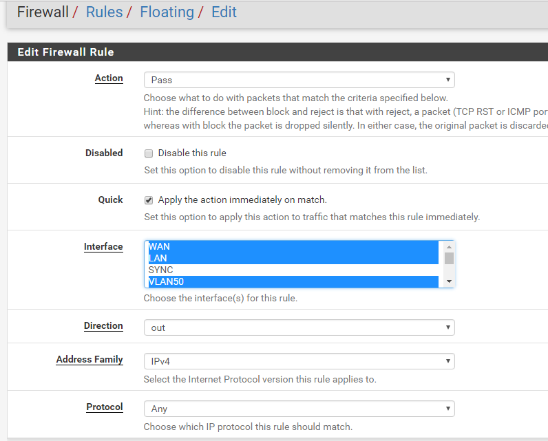

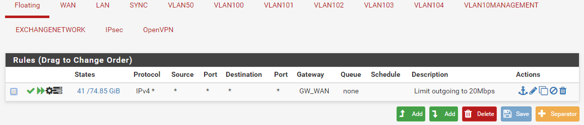

    I put the limiter under the floating rules:
    Float rule on all interfaces except for "sync":

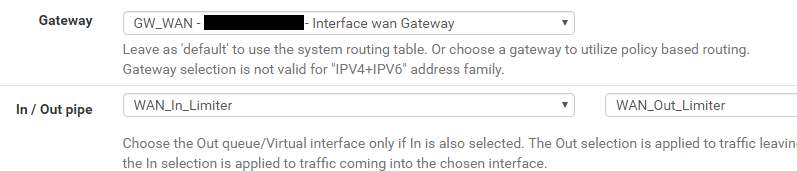

    Here is the "advanced" rule part where the limiter is applied:
    Shown below is the limiter that should be working but seems to be ignored. The "in" and the "out" limiters are both the same settings just labeled differently.:
