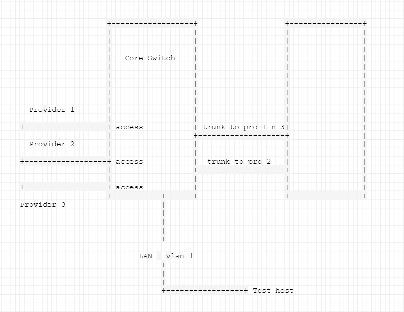

      Here is what I am talking about. First of all - a network diagram of the site that the particular PFSense resides (its the device on the right on the screen):
      At the moment we're in the process of replacing one of the internet providers (Provider 1 will be replaced by Provider 3). At the moment all lines are active and running. The LAN network reaches the PFSense over the trunk with provider 2.
      As this is a remote site, I have all traffic flowing over an IPSec tunnel to main office over Provider 2. The phase 2 entry on this side is from LAN network to 0.0.0.0, getting the entire traffic flowing over the tunnel. This is up and running fine.
