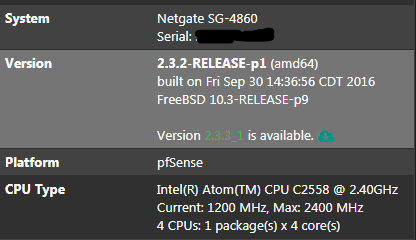

      Latest version (Currently 2.4.3) is not available for upgrade. Only 2.3.3 is available. Below text is from dashboard
      System Netgate SG-4860
      Serial: <Removed>
      Version 2.3.2-RELEASE-p1 (amd64)
      built on Fri Sep 30 14:36:56 CDT 2016
      FreeBSD 10.3-RELEASE-p9
      Version 2.3.3_1 is available.
      Platform pfSense
      CPU Type Intel(R) Atom(TM) CPU C2558 @ 2.40GHz
      Current: 1200 MHz, Max: 2400 MHz
      4 CPUs: 1 package(s) x 4 core(s)
      Is there any hardware limits preventing upgrade to the latest?
      Should do upgrade in multiple steps?
      Can I install the latest version(2.4.3) instead of upgrading?
      Is it recommended?

            arenel @jimp
            @jimp
            Thank you for your clear and prompt response
            If you let the upgrade run it should find the correct version. For older versions we don't always feed their branch the complete set of hints to the current highest version, but it can pick that info up during the upgrade.
            Thank you. I assume my device can be upgradable all the way up to the latest version(2.4.3 p1). Please let me know problem with that
            You could also set the branch to the 2.3.x legacy stable update branch to get it to 2.3.5-p2 and then form there move up to 2.4.3-p1. That step is not strictly needed.
            I could not see the 2.3.x legacy stable update branch option.

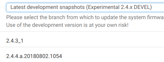

              Hi, I'm experiencing a similar issue on a
              System	Netgate SG-3100
              Version	2.4.3-RELEASE-p1 (arm)
              built on Thu May 10 15:59:52 CDT 2018
              FreeBSD 11.1-RELEASE-p10
              The system is on the latest version.
              Version information updated at Fri Aug 3 12:09:19 CEST 2018
              Should I upgrade to experimental to get the stable 2.4.4 ?
              Thanks, BR
              • jimpJ
                2.4.4 is not yet released. It's still in development.
                Do not Chat/PM for help!
