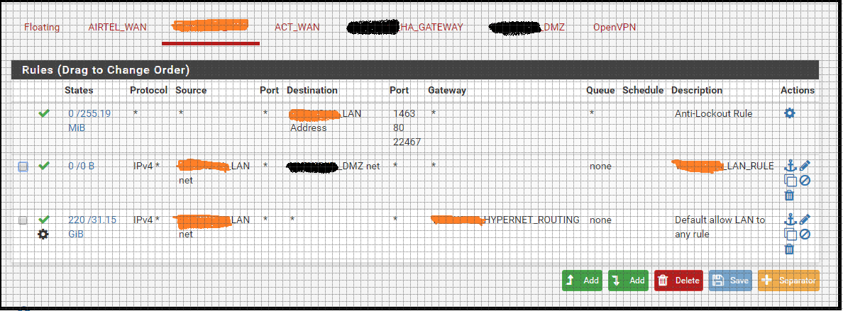

            Yes I have created a rule in LAn Protocol->Any Source->Lan Net Dest -> DMZ net. I can ping the gateway from the LAN host but not the DMZ servers
              post up your lan rules please - picture. The rule has to be ABOVE your policy routing rule. If it is and you can not ping host in dmz.. Then again is dmz host running a firewall that allows access from your lan net, is the dmz host actually using pfsense dmz IP as its gateway.

                  I
                    Well don't see any hits on that rule.. ie the 0/0
                    Sniff on pfsense lan, do you see your traffic hit pfsense dest for dmz? Sniff on dmz interface on pfsense - do you see the traffic sent to the dmz host?
                    If so then its on the dmz host.. This is like 2 seconds to troubleshoot.
                    Do you have any rules in floating? Like blocking access to dmz, which would explain why you have zero hits on your dmz rule.

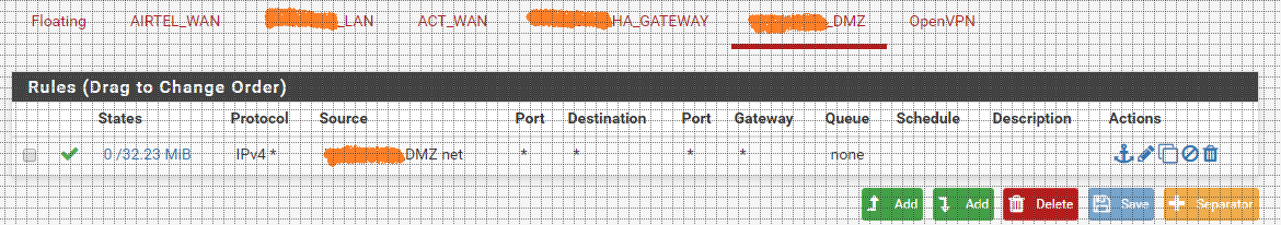

                        Su30MKI
                        I have enabled Snort on DMZ for IPS. Could that be an issue?
                          Dude your rules on dmz have ZERO to do with the problem..
                          You don't need any rules on dmz for lan to talk to dmz.. The return traffic from dmz back to your client starting the conversation with some on dmz would be allowed by the state.
                          If not then do a simple sniff on lan - do you see the traffic from your lan host going to your dmz IP your trying to talk to.. Great.. Do same sniff on dmz interface - do you see traffic when you try and talk to dmz? If so then problem on your dmz host.
                          Post back with your sniff results.. I can duplicate this for you in like 2 minutes if you need to see pictures or something..
