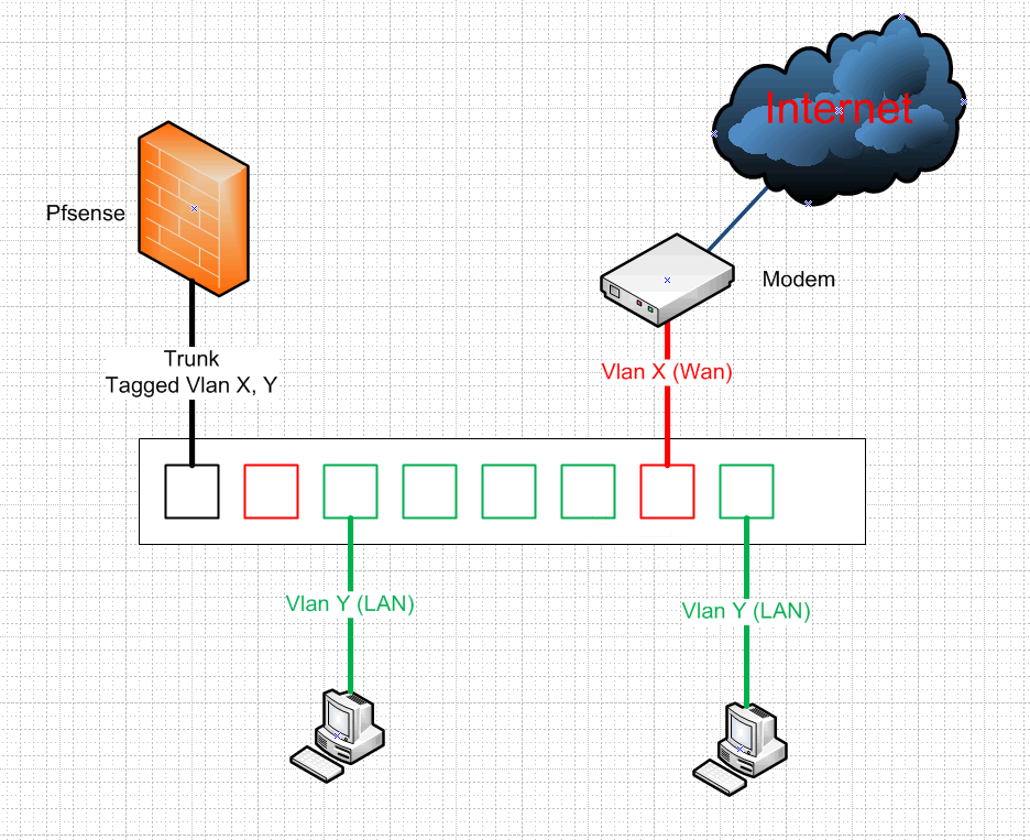

                                • johnpozJ
                                  If you do not understand what a vlan is or how to set them up - then this is going to be a very difficult process!!
                                  Does this help?
                                  You can use whatever vlan IDs you want 100, 200. One is wan and other is lan. You setup your switch so ports are in the vlan you want in access mode with the vlan ID you pick. Red is wan for example. Other ports where your lan devices are (green)
                                  The port connected to pfsense will be trunked or (tagged vlans with your ids)
                                  Setup your vlans in pfsense where 1 vlan is your wan, and other vlan is your lan.

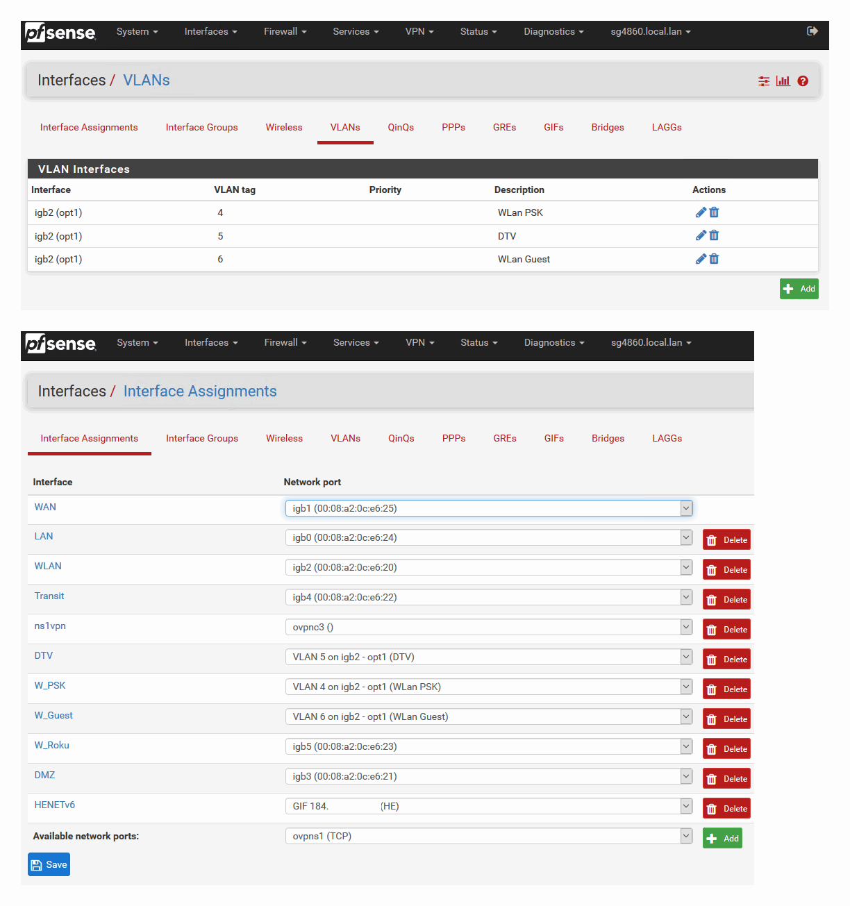

                                  Here for example are some vlans I have that are running in my igb2 interface.
