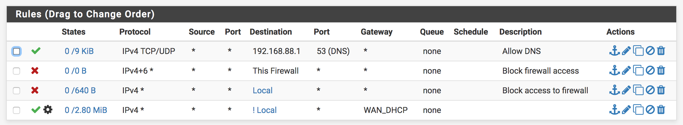

              I already have similar rules on the OpenVPN rules tab, but the rules do not seem to block as intended, and local access is still happening. Here is what I have:
              ("Local" alias is all my local subnets other than the OpenVPN subnet)
              Any suggestions?

                Whats the Advanced filter rule at the bottom doing ?
                Also why the gateway, do you have a multi wan set-up?
                Andy
                • P Offline
                  pfguy2018
                  The only advanced option is the gateway - WAN_DHCP. I am not using a multiwan setup, but there are several outgoing OpenVPN clients. I think I stuck the gateway in there to make sure the connection went out over the WAN connection rather than the OpenVPN client connections. Is that somehow causing the issue?

                    Not sure but there is no need if you have a single wan connection.
                    try enabling logging on your rules and see what rule is being hit.
