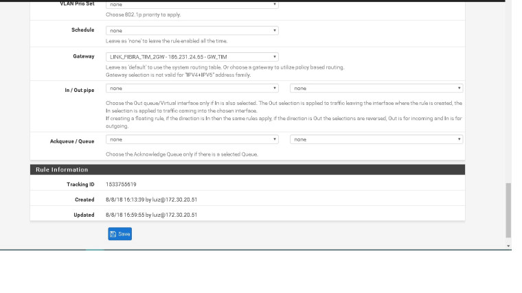

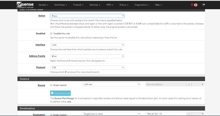

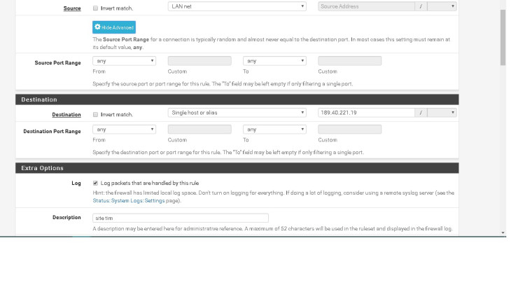

                  I did it the way you said it, but nothing yet. I noticed that the virtua is as default, you know if you can to leave the tim link as default?
                  3_1533758767731_pfsense.jpg 2_1533758767731_pff.jpg 1_1533758767729_pf.jpg 0_1533758767694_a.jpg
                  I left these settings, are they correct?
                    You might want to set protocol to any of you need more than http(s).
                    That rule must be above your load balancing rule in the LAN rules.
                    You might need more than just 189.40.221.19 as the destination. timcommerce.com.br resolves to a different IP for example.
