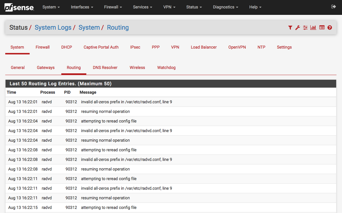

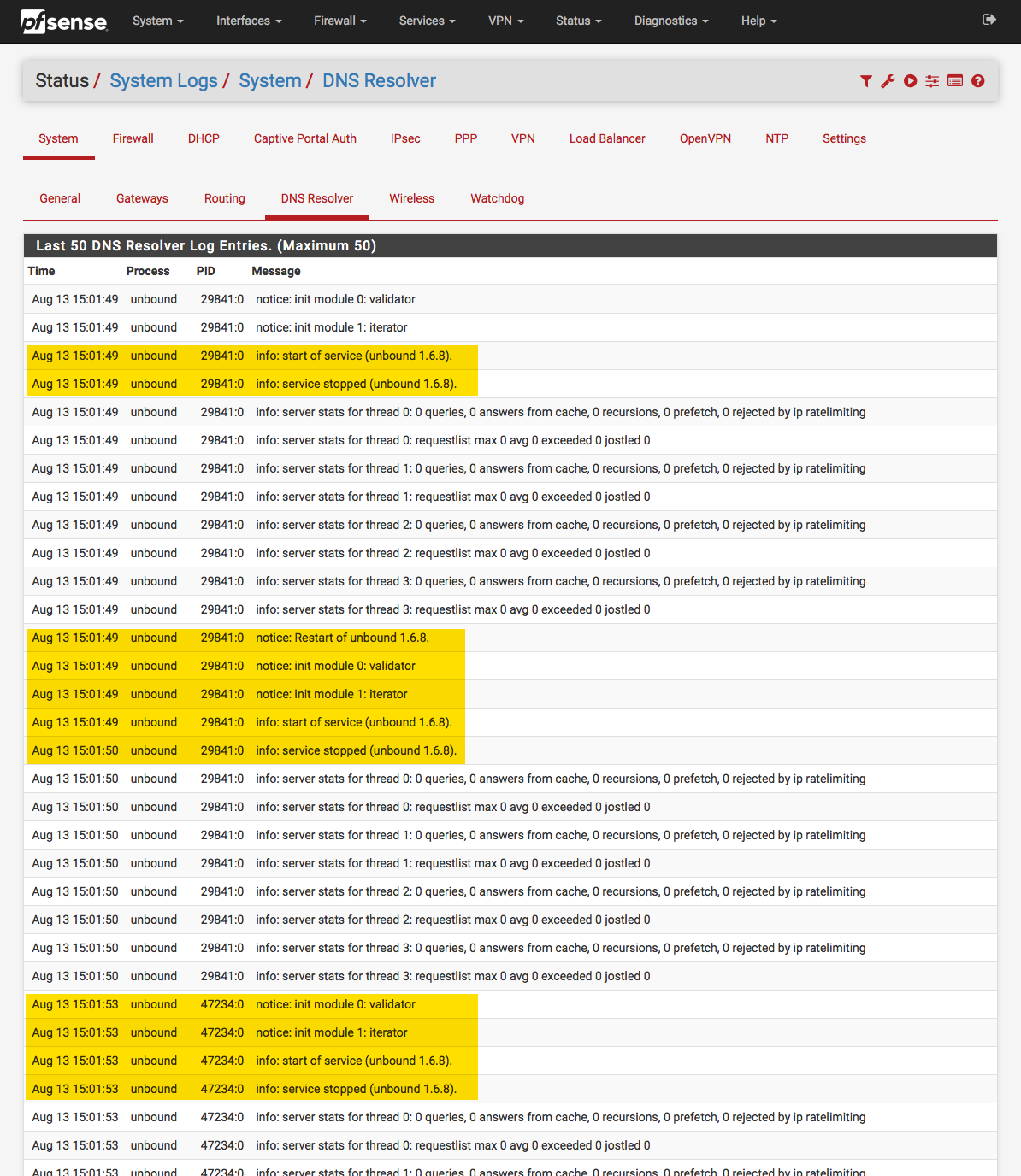

      I am not sure if, somewhere, I made a change that results in this whole issue, but whether I use the DNS resolver or the DNS Forwarder (I tried with both, not at the same time), the services will stop all the time. As a matter of fact they pretty much stay off. When on, it's for a few seconds at the most.
      I can hardly connect to any webpage. When it works, for a few seconds all is good. Otherwise (most of the time) most pages just time out.

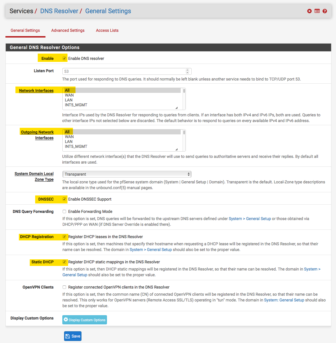

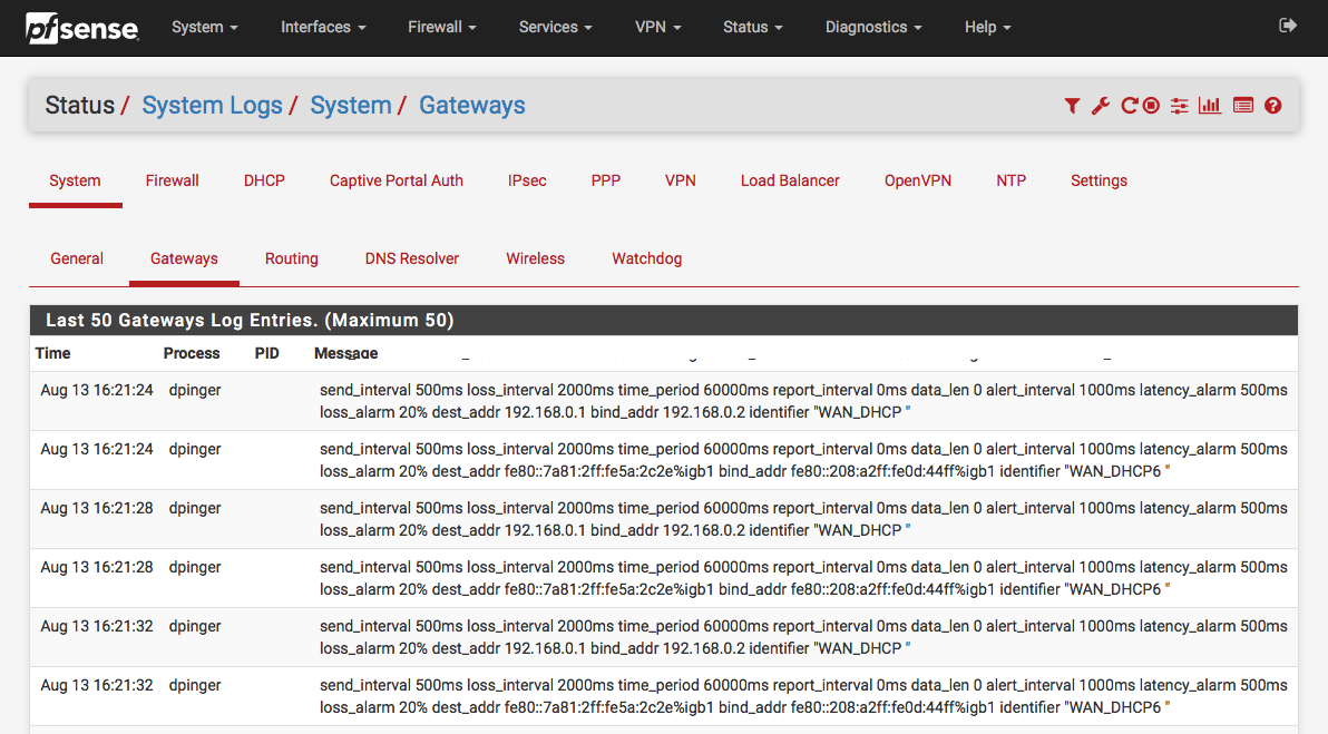

      I attached the screenshots of my settings and a few logs.

      Finished the wizard and... right away the DNS Resolver starts and stops again.

        Well, for those who might run into something similar, the solution in the end was to deactivate everything IPv6 on the interfaces and in DHCPv6 server.
