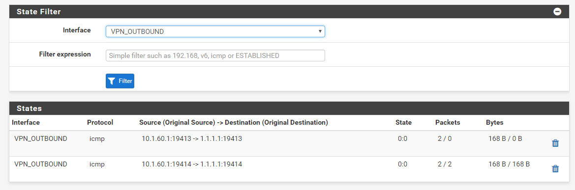

This is what the states now look like:
And this is the output of
