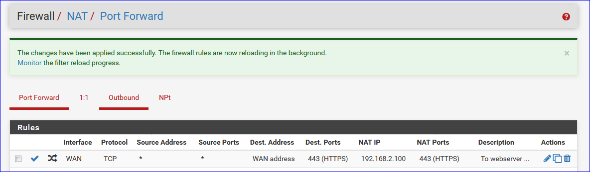

    “The following input errors were detected: is not a valid redirect target port. It must be a port alias or integer between 1 and 65535”
    I did internet searches and didn’t find a lot on this error .
    The selections made under NAT/Port Forward/Edit; the rest left at pfsense default
    • Interface: WAN
    • Protocol: TCP
    • Destination: WAN
    • Destination port range: 443
    • Redirect target IP: 192.168.2.100

      Strange, your are omitting the "Redirect target port" field.
      It should be
      Redirect target port : 443
      en then pfSense will accept your NAT rules :

        Thanks so much. Problem solved. Its the small things that are overlooked.
        Its been a crap day solving problems that I didnt even see that one.
        Appreciated!
