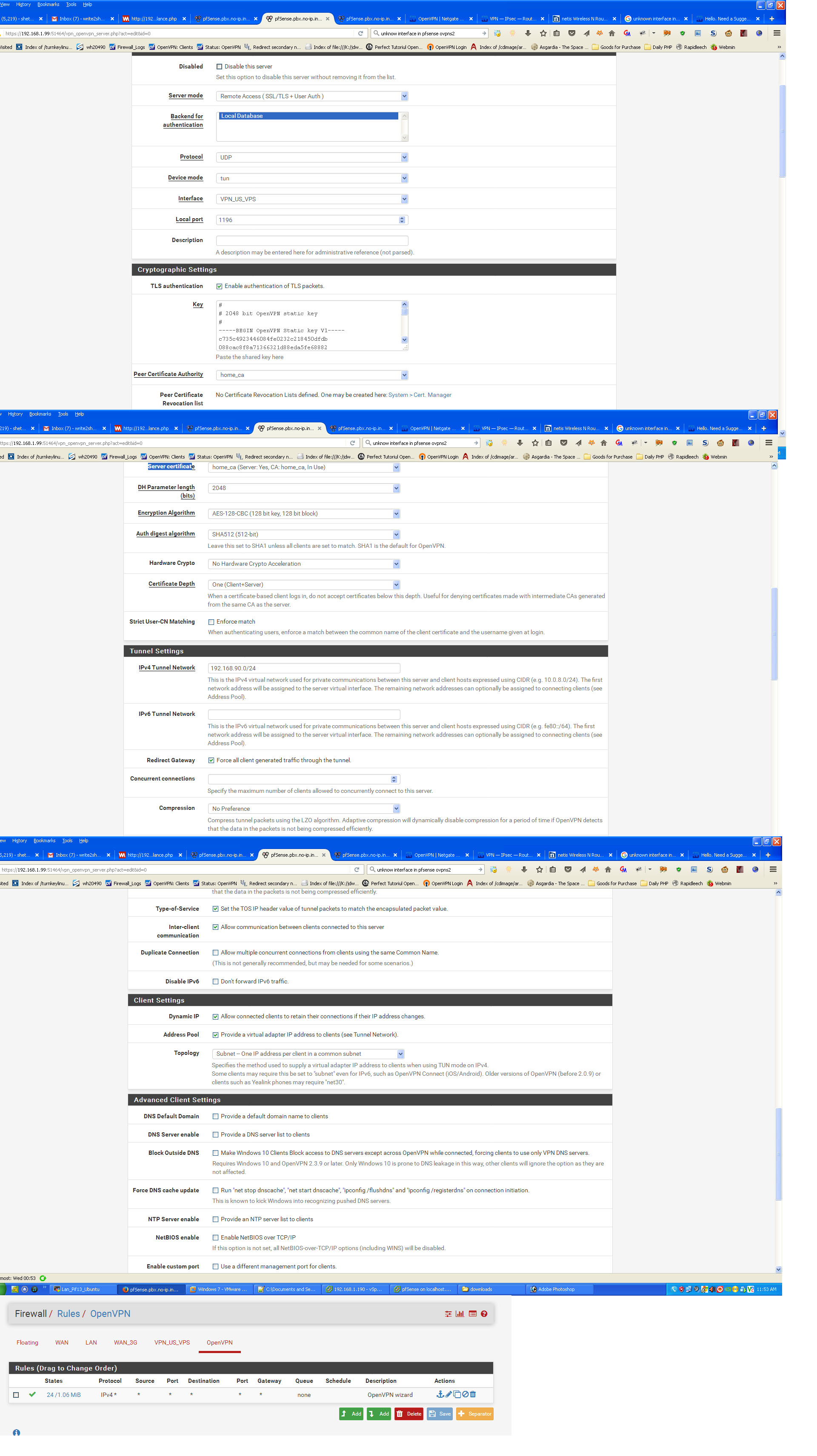

      I have pbx in flash server behind pfsense. I can connect from mobile phone but audio has oneway. In home there is no audio problem.
      I create openvpn server using external openvpn server ip. Becuase I have nat ip. Here is my openvpn server config. I stuck there few months.
      My Lan subnet : 192.168.1.0/24
      Openvpn subnet : 192.168.90.0/24
      I post a screenshot. If you time please read this and tell me what to do?
